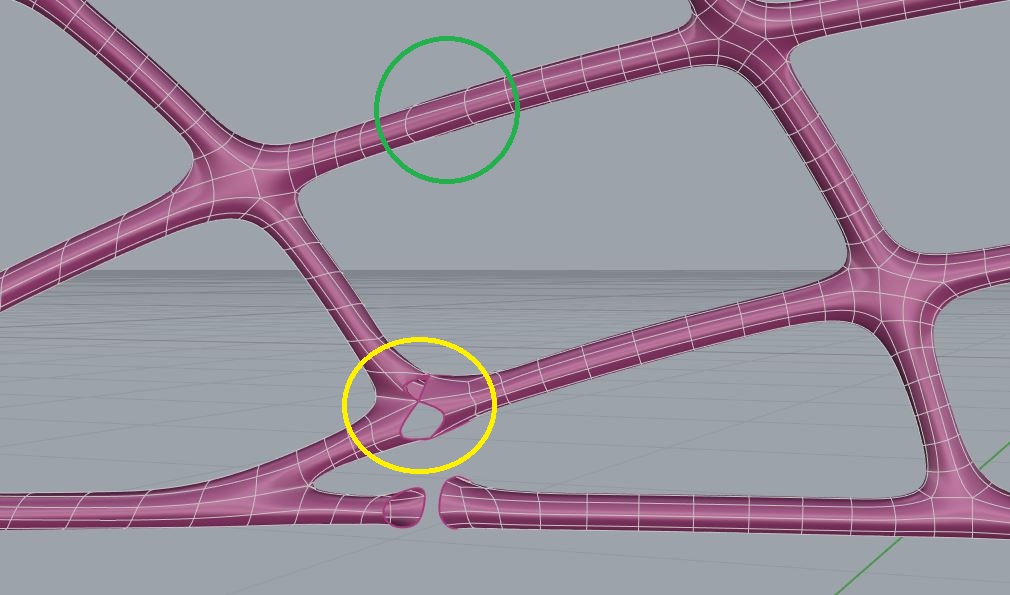

I remeshed the model to 500k vertices (1 million tris).
Unfortunately, quadremesh still does not work on the full model even if you simplify it.
But when you separate the model in sections (splitmesh with drawn curves), it will work- i used target surface amount of 1000.
Afterwork ist tedious and time consuming, as you need then to stitch the sub-d pieces together.
