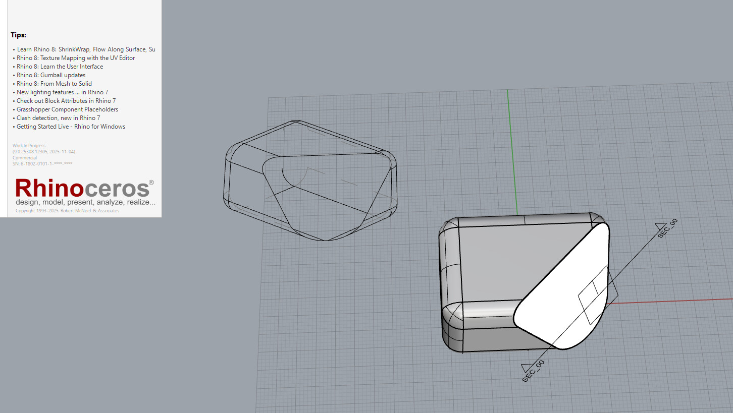

Hi all, wanted to share a prototype (work-in-progress) to create static copies of clipping-drawings and place the output in source layers. It does not support dynamic update with model changes. The likely application of this feature is to enhance NestedClippingDrawings command that currently extract static copy of sections (without background). However, it might be applicable to maintain source layers to ClippingDrawings command.
This is how to run it:
  • Download the latest Rhino WIP…
  • Run CloneClippingDrawings test command (type the full name- doesn’t auto-complete),
  • Select Clipping-Plane,
  • Press Enter to project-in-place, or pick a point parallel to world xy-plane.
Notes:
  • Section and Background objects are grouped separately.
  • There are nested groups for the types within each group (section-hatches, hidden-curves, silhouettes, etc.).
Please give it a try and let us know if it is useful in your workflow and if you have any suggestions. Thanks!

  1. Is it possible to extract tangent edges (from background) as a separate set of curves?
  2. The biggest disadvantage of having Drawing’s elements at the same layer is taking out the ability to easily separate Hidden status of 3D objects and ClippingDrawings. You will not be able to turn on/off ClippingDrawing in Model space and Details under Layout.
I would still propose creation of separate set of same layers under main ClippinDrawing’s layer. This will make drafting process much easier.

Would it help if there is a command, say “HideInModel”, that enables hiding drawings in model while remain visible in detail? As for hiding sub-categories (like hidden-lines), the prototype attempts to solve through grouping. but of course this is not as easy as hiding layers, and I understand this to be an important shortcoming.
I also appreciate the elegance of removing the need to duplicate layers, and the ability to directly select, copy and modify drawings.
Layout visibility can be perhaps resolved by adding support to Hide-In-Model (similar to HideInDetail command). I’ll look into this. Also we probably need to resolve selecting nested groups (without having to explode the top-level group).

I think it’s available, since there is possibility to do this and this. Somehow it is allowed to recognize tangent edges of a polysurface.
We need to have freedom of independent changing linetype and lineweight of silhouette, tangent, hidden and sharp edges-related curves. Also, easily controlling visibility of such groups of curves. Which is partially already implemented by you for silhouette curves.
Thanks again for keeping interest to ClippingDrawing development. This eventually should make drafting rich and flexible, and dynamic at the same time.
You are right. I added a request to add tangents here…
