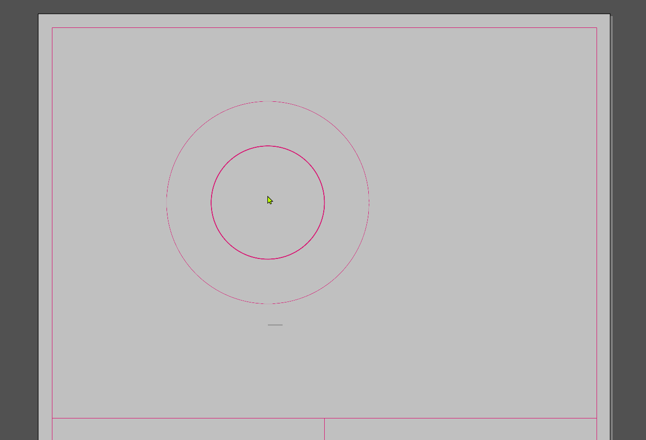

  6. If i set option to show background then it also shows the geometry behind section (where nothing should be visible except hatch)

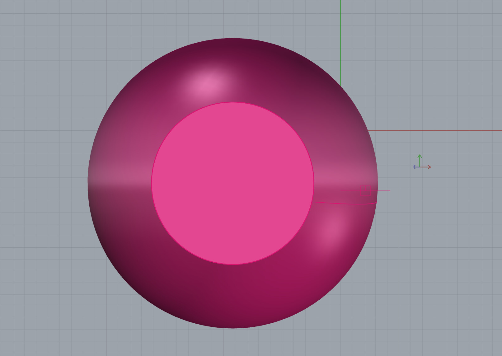

I think this problem still persists:
0714-2B.3dm (2.7 MB)
Rhino 8 SR10 2024-7-23 (Rhino 8, 8.10.24205.13001, Git hash:master @ 20bc3267cc7d3ea766e91bec2ff8ef5ff8fb1755)

For this part, does the following Macro help?
!ViewClippingSections Pause Clip=No SetView=Yes SetCPlane=No Enter
I see it. I reopened the bug.
