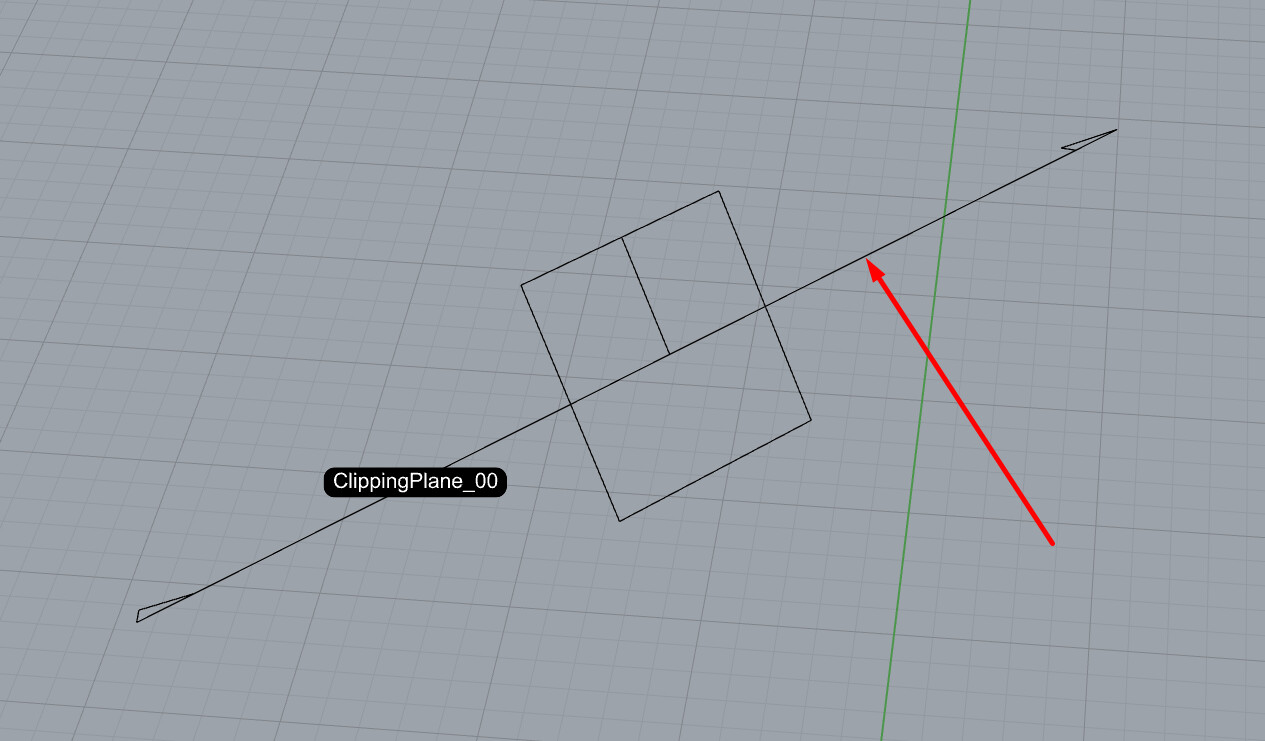

Rajaa, in that image, you are pointing to the wrong edges:
I’ve added that request as RH-90443 ClippingDrawings: Include Annotations
