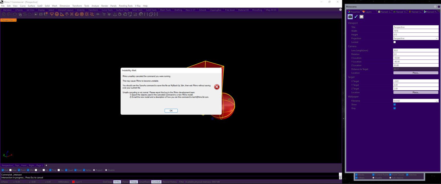

I’ve been waiting for some updates on Rhino 7 to see if there is an improvement but this issues keep happening.
I’m having several problems where Rhino takes way too long to work and it even crashes
Examples are:
1- Editing a dimension with the Properties window. It just takes forever to load. And this is just selecting one dimension. When I go to select another one, the same happens. It freezes for a couple of minutes. This used to be so smooth.
2- TEXT: this takes at least 3 minutes to start and work. And if I press ESCAPE, Rhino crashes.
3- Intersection between surfaces, solids or any type of object. This straight up does not work. It freezes for several minutes and then Rhino crashes.

Do you see many other posts about such egregious issues? We’re going to need some information to actually help, like files, and running SystemInfo and posting the results.
Hello- yeah, a starting point would be to run the SystemInfo command in Rhino and copy/paste the results here.

Deactivate V-Ray and try again…
Obviously if these were common problems there would be lots of other posts screaming bloody murder, and without examples there’s virtually nothing to do to try to track them down.
The most likely culprit here is one or more of your 3rd-party plugins.

Update your video drivers, restart Windows, disable the rest of your add-ons. Also, post a file.
I’ll try this later on the day, thanks. Graphic card drivers are up to date and Windows 11 also up to date.
No luck guys, I just disable all add ons that don’t come with Rhino, re-started Windows, and nothing changed… When the Properties window is active, Rhino freezes… It’s just weird. When I turn it off it’s all ok.

This images are performing INTERSECTION, it froze after 1 minute, when I pressed ESCAPE, it crashed.

Is Vray uninstalled completely? this was a know issue somewhat recently (intersection/contour command vray conflict)
I know right? I just updated Nvidia drivers and the problem persists. Properties panel is the problem. When I turn it off it runs smooth.

Is V-Ray up to date? And you need to isolate the problem, obviously “intersect” works just fine for everyone else.
