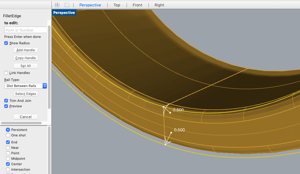

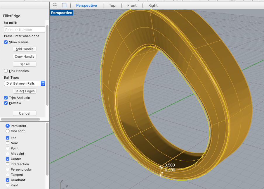

Here are the screenshots of the process of the fillet edge command. I created this ring by first making curves then using the loft command to make the surfaces. I then joined the surfaces together to make a closed solid polysurface. Maybe something in my process was off which is why the edges keep breaking…I’ve also seen lots of people mention tolerances on this forum which I don’t really get. Maybe that’s an issue too.
Thanks for your help! J

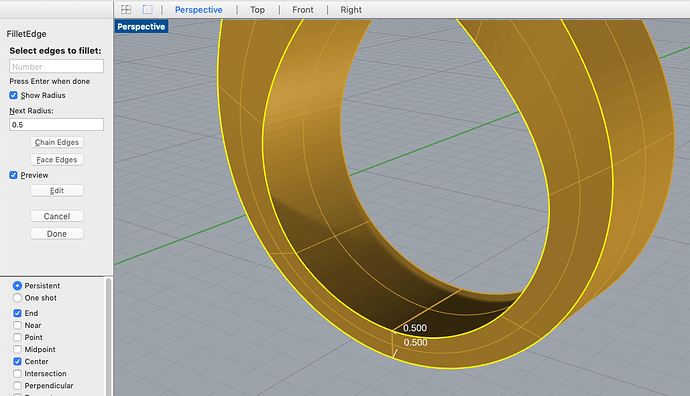

One more of the whole ring. Maybe it’s something about the design…

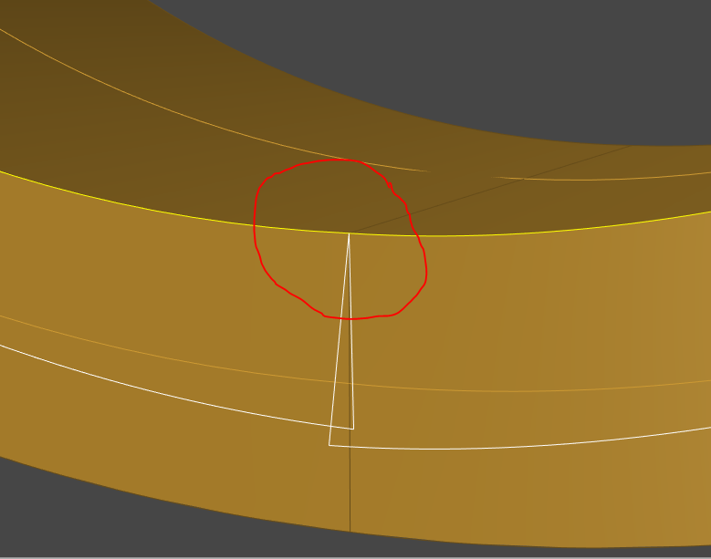

The file already has the fillets, but I was able to remove them and untrim the surfaces to get back to the unfilleted condition. The problem is on the bottom edge, your edge/surface isn’t continuous - it has about a 1.5° tangency break. Probably due to your original curves not being clean in that spot.
I turned on curvature graph on that edge and you can see the break clearly.
So you probably should go back to your original generating curves and fix those then try re-making the surfaces. Fillets are pretty sensitive to small tangency problems.
