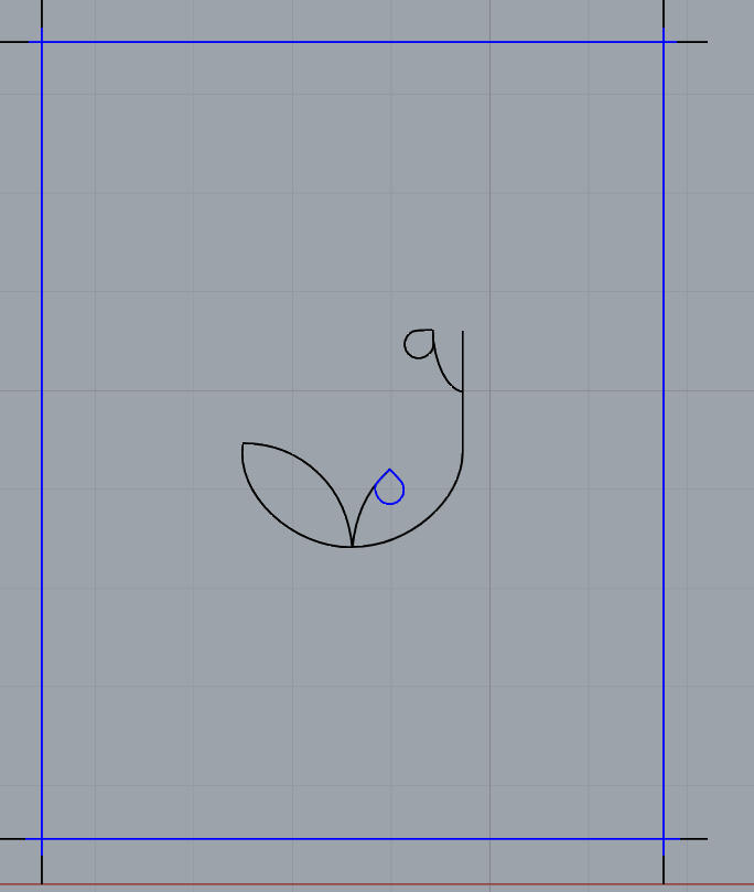

I am facing a weird but really painful issue when importing PDF files into Rhino : sometimes but not always, the color of objects is changed during the import. For example, a curve which is blue in a PDF viewer will be black in Rhino. This is usually happening when the PDF has been generated through Illustrator. I attached two PDF giving me this problem to this post.
This is a real pain since we use Rhino for Laser Cutting Time estimation, which highly depends on the RVB of each curve/surface. I use Rhino 5 SR13 64-bit
Has anyone faced this issue before? I highly suspects it comes from the PDFReader Plug in which is not dealing correctly with color settings (RVB, CMYK). Is there another plug in to be used for that purpose?

Yes that’s what I am seeing as well in Rhino. But what do you see in a regular PDF Reader like Foxit or Adobe?
The center part of the flower in blue should actually be black.
Hi Xavier - I see the closed curves with black fills and strokes both, no blue stroke on the one curve - is that the problem? But so far no curves that are blue in AI are black in Rhino. The small curve that is blue in Rhino has no separate outer curve like the other filled shapes in AI though, and has no stroke applied in AI.
Yes, that’s the issue : the color of the middle closed curve is changing from black to blue. I have never seen the other way around neither. I am not really proficient with AI but how can a black surface with no stroke becomes a blue curve in Rhino?
Hi Xavier - that curve does not have a stroke applied at al, as far as I can see, in AI … why it is assigned blue in Rhino, I do not know . But, it is not a surface, it is a curve with a fill - Rhino currently only sees the curve.

Yeah - thanks, this certainly looks incorrect to me. I’ll put it on the bug list. I can’t recall this coming up in the past, but I would think someone would have noticed! Thanks for the example. https://mcneel.myjetbrains.com/youtrack/issue/RH-37213

When I open it in Inkscape I can see the colors and also in the file preview in Windows Explorer the colors are there. Just not in Rhino.

I’m not sure what @ChrisK is doing differently but from what I see when I import those in the current WIP, there still is an issue with the colors. That is why Pascal reopened that bug report. The release target is set to 6.0 so that would mean that it will get attention rather soon-ish. It’s odd (to me) that this issue persists after a complete overhaul of the PDF system in Rhino, @stevebaer?
