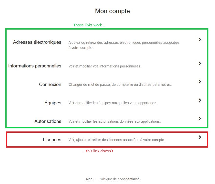

When I try to check my licenses attribution on the rhino account site, I always get an error with that picture :image
In Rhino, I see that my mail address is correct, but it doesn’t mention the team, and as long as my mail address is registered in two different teams, I don’t know where my license come from.

My account connection is fine, it’s the license page which is not displaying. For few days, I get the sad Rhino image instead of the license manager tool.
I just looked, an you do not have a permanent V6 license in that account.
There are two expired V6 beta licenses.
Assuming you purchased a V6 license, I suspect you may have a second Rhino account under a different email address.
Click on the first option to see the email address on the Rhino account you’re logged into.
Is that possible? It seems likely to me.

Changing email address is the problem.
We link your address to your Rhino account and to your license when you Validate it. It is our primary way of identification.
Please contact the regional Sales and Technical support. That’s probably Barcelona.
You can have multiple email addresses in your Rhino account, and you can choose which one is Primary.
They can look up your license key and figure out where you have it currently, change email addresses in our system and get you sorted out.
The way our system is designed, when you change your email address and don’t include us in that updating, you are a different person entirely.
