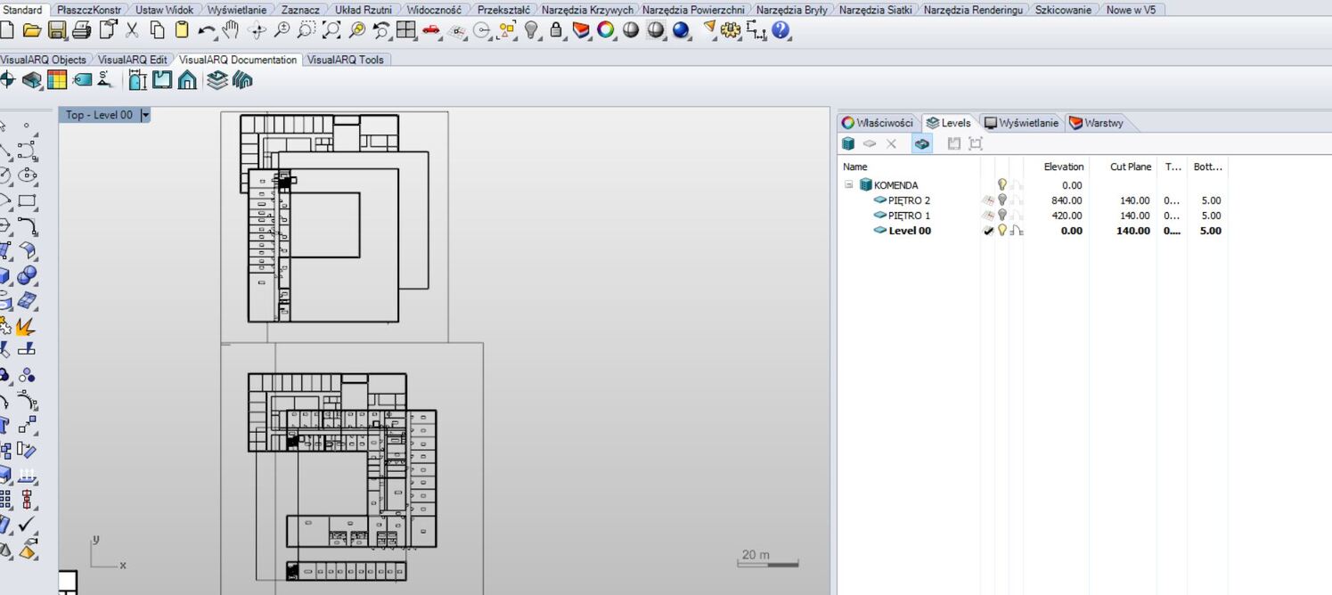

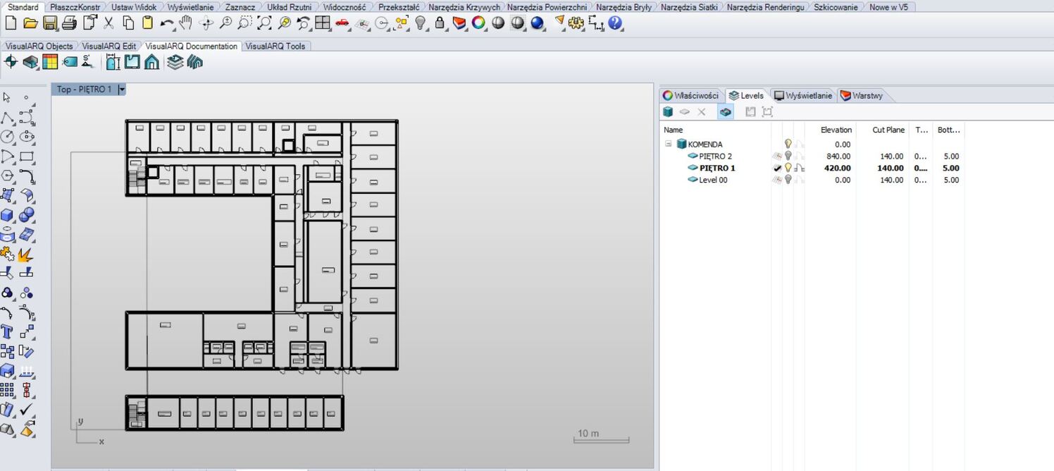

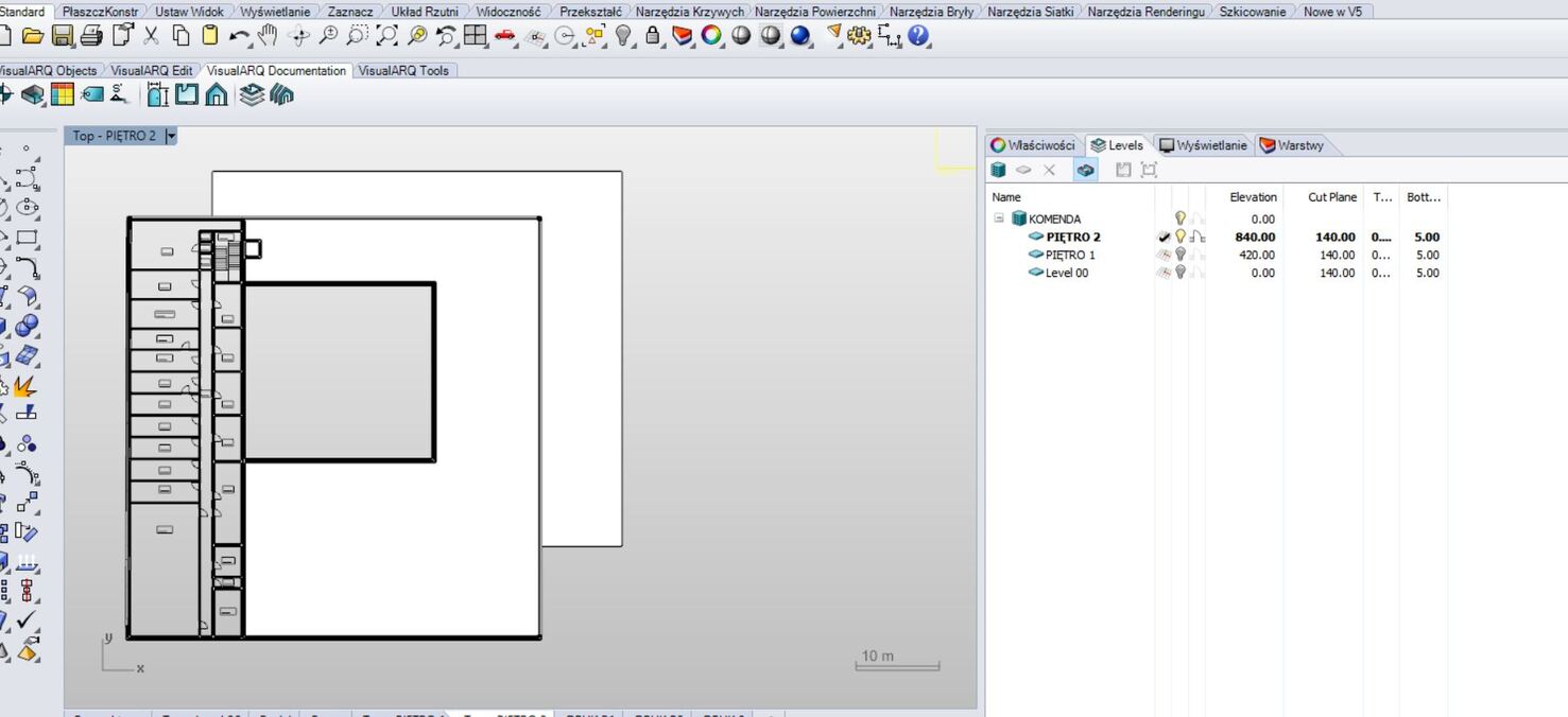

I’ve problem when try to create plan view a level. I’ve 3 levels - each 4,20 m high.
Durring creating level 1 and level 2 i see plan view from groundfloor (level 0). Do you know why and how solve problem ?

Is it possible that in the plan view properties you have selected “Unlimited” as view depth? If so, please, select Level or Level Below depending on what you need.
