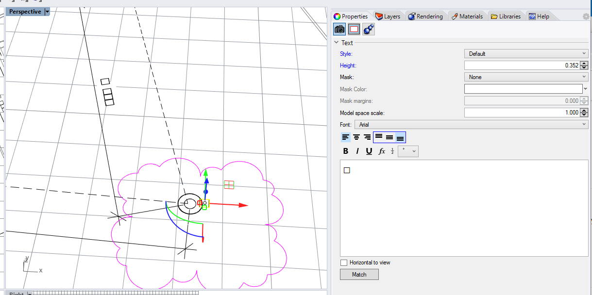

I just did some tests with the latest SR but same issue:
As you can see the text reads in as a “square” in Rhino:

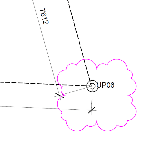

And the same PDF in acrobat:
I sent you the PDF in a PM.
Note that this PDF also has one or more objects that messes my Rhino up. If you select a few gray objects and run SelColor then it quite quickly selects all gray lines (42.000) and if you hit HIDE then it takes for ever for Rhino to hide them. (So long that I had to terminate Rhino) Running Invert also froze Rhino for me. So maybe a bad hatch or something, but I think Rhino should be able to detect these objects on import and skip them. Take a look and see if you get the same behaviour.

So far, this PDF is an absolute mess.
Loads of duplicate objects and each thing that looks like a dimension is a stacked up pile of multiple text object.
It won’t even open in V5.
This looks like multiple problems and will take a while to dig through.

I can’t figure this one out.
PDF’s tend to break down text into smaller patches and here the pdf exporter (not rhino) must have broken it down into letters. But Acrobat manages to sort it out, so it can’t be a total mess after all.
And I can select the text in acrobat too:
