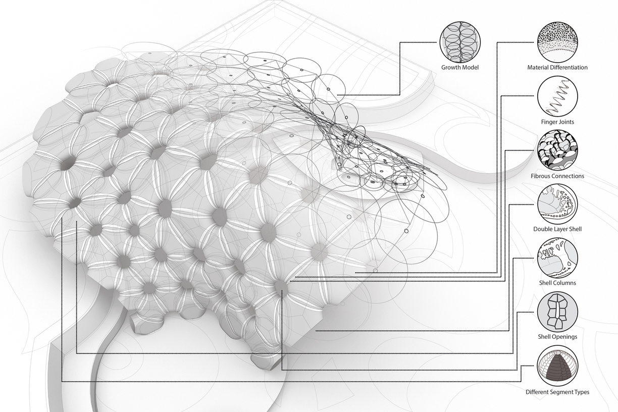

If I remember correctly ICD used an agent based system for the panelling, not just plain circle packing. Nevertheless what you see as panels is the mesh dual of the delaunay mesh of the circle center points.
The theory behind why that approach is used is that if 3 edges meet in one vertex the mesh is easily offesettable whithout planning cutouts.
The picture is from this german paper by C. Robeller: https://www.researchgate.net/publication/329423938_Timberdome_Konstruktionsystem_fur_Brettsperrholz-Segmentschalen_ohne_Schrauben
Here is a post by Daniel Piker from the old forum, the gh files might produce errors, but the principle should be understandable. https://www.grasshopper3d.com/group/kangaroo/forum/topics/relaxation-of-points-meshes-constrained-to-a-surface-circle
The only problem with your mesh atm (atleast the one that was referenced in the 2nd file) are the holes, so either delete these faces from the delauny mesh or use a different technique to get to the delauny mesh.
