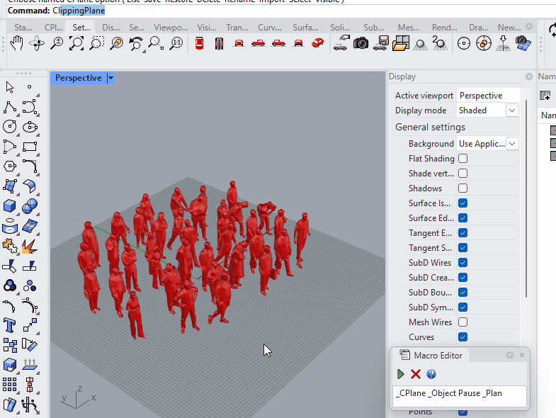

We cant use this macro with the new clipping plane can we? is there a quick workaround?
Pls give it a try with _CPlane _Object Pause _Plan
noOrient
CPlane doesnt set to my clipping plane

I’m fairly certain it’s the new clipping plane and not my system or settings. It works fine on regular geometry. Did you try it on a clipping plane with a non-orthogonal alignment?
The best workaround for me is: _SaveClippingSectionViews, which saves a named view

Auto Align CPlane ( Enabled=No Mode=Object Locked=No Sticky=Yes )

Hi Guido -
That needs to be set to Enabled=Yes for this to work.
Animation
I still can’t get it to work this way
