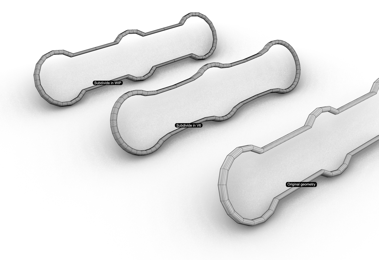

Hi @dalelear
I dug a little further, and it seems that it’s NOT the settings - it seems as if the level of subdivision or maintaining creases/corners has nothing to say in this matter. I’m not really an expert in mesh-lingo, so I’ll try to explain. Look at the attached screen grab.
The part is from a car dash that was bought as a mesh model, and in order to get a smoother mesh for rendering, I use Subdivide to smooth the rather coarse mesh - usually once or twice depending in the level of detail needed.
As you can see, the V6 version “interpolates” the coarse mesh, making it more and more soft/round for each round of subdivision. The WIP version “just” subdivides the existing polygons in their place, adding the needed faces, but not rounding them off. So it might be a completely different command I need? I’ve tried to see if the weld angle would have anything to say, but I can’t seem to find a solution that works. Am I barking up the wrong tree? File attached (in V6 format) for reference.
Subdivide V6 vs WIP.3dm (601.1 KB)
Thanks in advance,
Jakob

Hi, Jakob,
I finally had time to look into this.
In V7 WIP SubDivide on a mesh leaves existing vertices in place.
Apparently, in V6 SubDIvide treated the mesh as a Catmull Clark control polygon and subdivided it.
One workaround for the current V7 WIP is to
  1. Use ToSubD to convert the mesh to a subd (deleteinput = true)
  2. Run SubDivide on the SubD.
  3. Use ExtractControlPolygon on the SubD to get the Catmull-Clark subdivision of the input mesh as a SubD control polygon.
I’m still trying to understand why this change was made.
