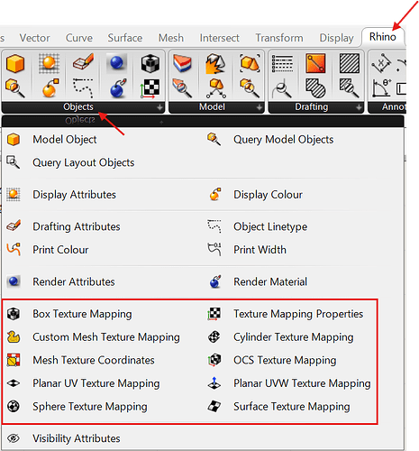

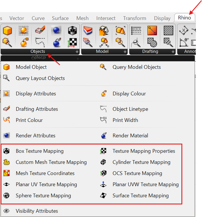

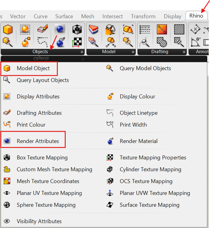

The Rhino tab > Objects section, contains the texture mapping methods that can be used for either referenced geometry or for objects created within Grasshopper.

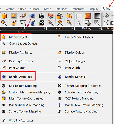

In this same section, the Model Object and Render Attributes components are used to define and change the object properties in the Rhino document as content is pushed to it from Grasshopper.

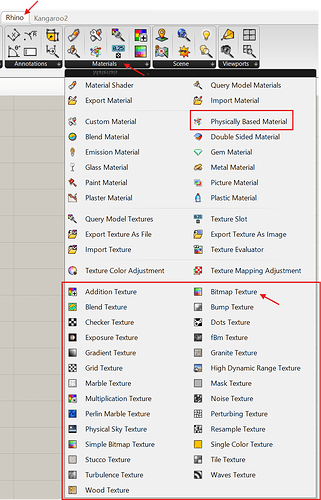

The Rhino tab > Materials section, contains components for procedural or bitmap textures that can be used within a material assigned in Grasshopper. Both the texture and the material are pushed to the Rhino document along with the associated objects.

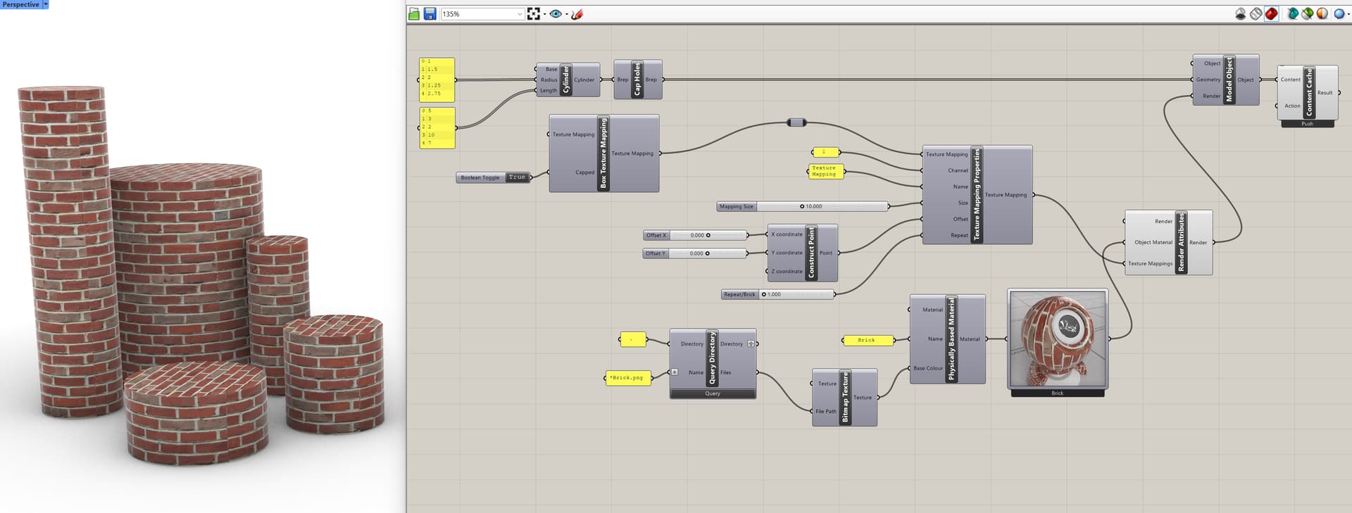

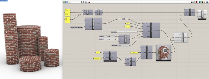

Download and extract the attached zip folder to find these components combined in the simple Grasshopper example seen below. Note that any of these new components can be set to hide or show unused parameters via the right click menu over the center of each component.
