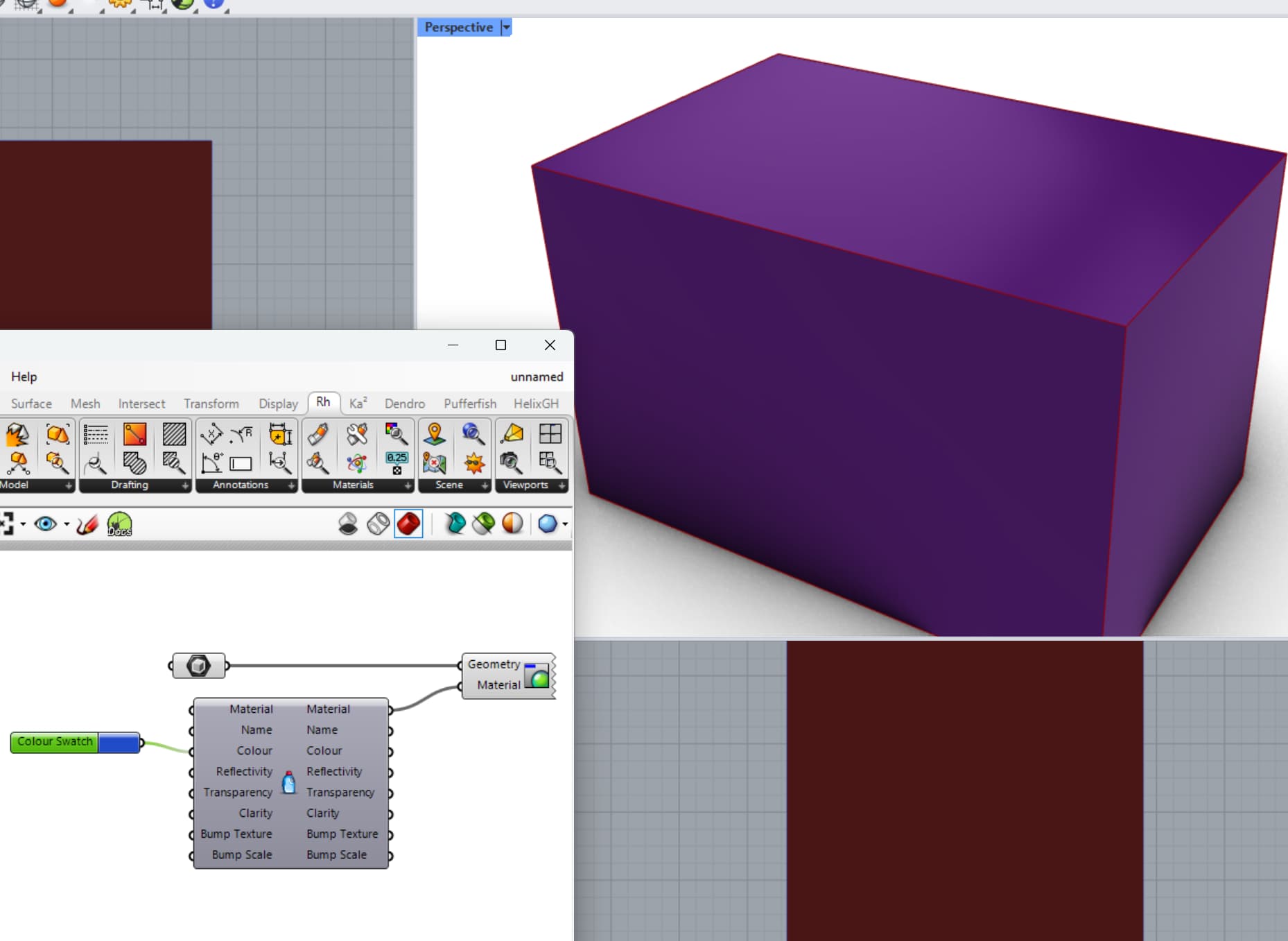

The simplest of definitions to use Render material in Grasshopper and visualize the results in Rhino. We will build on this definition thru the rest of this guide as it allows us to monitor all the changes we are making.
Note: A Material exists in Grasshopper only until it is pushed into Rhino using the Content Cache Component.

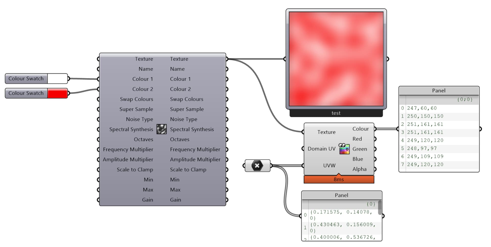

  1. Most Color Channels can also take a texture. In the case above, a Grid texture is created and pushed into the Base Color channel.
  2. Other strengths such as Metallic and Roughness are a 0.00 - 1.00 value.
  3. Outputs for the material may be a value, or a complete texture as seen in the Base Color example above. Use a Render Preview component to interrogate the output for the type and the values.
