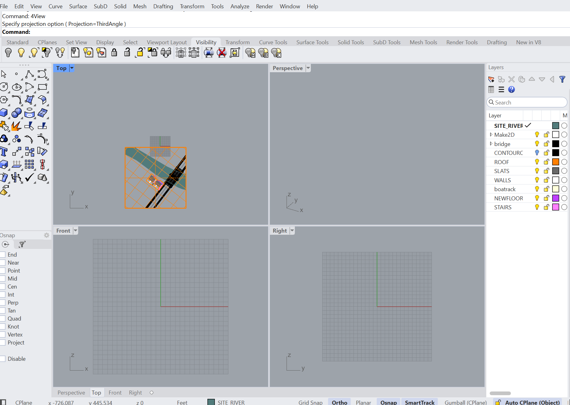

Object only visible in Top view; disappears in all other views including Perspective. Grid missing in Perspective viewport.
Description:
I have an object positioned near the origin that is fully visible in the Top view. However, in all other views (Perspective, Front, Right), the object disappears when I zoom or pan. The Perspective viewport also does not show the origin grid.
  • The object is not flat (it has volume).
  • I moved the object to the origin to test.
  • Switching display modes (Wireframe, Shaded) doesn’t resolve the issue.
  • I reset all viewports using _4View and zoomed to extents.
  • Exporting the object to a new file did not fix the problem.
  • Attempted camera clipping plane resets using Rhino Python scripts (near/far plane distances) but encountered errors or no effect.
  • The grid does not show in Perspective view even after resetting views.
  • I tried creating a new Perspective viewport, but the issue persists.
I suspect a viewport or camera clipping problem but have been unable to fix it.

Hi Mia -
There are no clipping planes in your file?
I’m not sure what “unknown result” means. When there are bad objects, those get selected and reported on the command line, when there are none, that is stated on the command line.
In your file, the command line reports:
Command: SelBadObjects
1 curve, 27 polysurfaces, 5 extrusions added to selection.
How did you perform that test?
When I check for distance from the world origin, I get this:
Command: Distance
CPlane angles and deltas: xy = -66.425 elevation = -90.000 dx = 178.378 dy = -408.787 dz = -756864974828985.375
World angles and deltas: xy = -66.425 elevation = -90.000 dx = 178.378 dy = -408.787 dz = -756864974828985.375
Distance = 756864974828985.375 feet
1 hatch, 6 block instances, 27 curves, 1 surface, 30 polysurfaces, 61 extrusions added to selection.
When I select everything and move that to the world origin:
Command: _Move
The “Move” command created 26 bad objects.
Command: ZEA
Command: '_Zoom
Drag a window to zoom ( All Dynamic Extents Factor In Out Selected Target 1To1 )_All
Choose option ( Extents Selected 1To1 )_Extents
I am still unsure on what you did exactly to make the objects show up, is it possible for you to send me that file that you screenshotted?
Your boathouse is literally 143 billion miles in the air (and there won’t be any air)
Steps
  1. Make sure the Project object snap is turned off
  2. Select all objects in the Top View
  3. In Top View pick any point on the geometry
  4. Then type 0 in the command line > Enter
This will move all the geometry in Z to the world origin of 0 and now all your view window will zoom and display has you intended.
