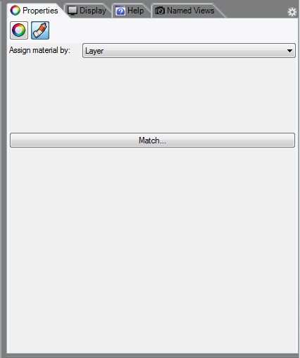

Missing V4 functionality in V5 material properties panel
In Rhino 4 when an object’s material was assigned By Layer, we could still see what was the material:
Quite handy.
In V5, this panel looks like this:
Not useful.
To know what is the object’s material, we need to click on the properties icon to see what is the layer the object is on, and then check on the layer panel what is the material assigned to this layer.

Rhino 4 used a basic material by default for plug-in materials. You had to explicitly change the radio button in that version, so there’s no question of Rhino 5 not “respecting your choice”.
I understand that the “Plug-in” checkbox is more difficult to find in V5. However, there’s a reason for this. We are trying to wean plug-in developers off the old “plug-in” system and into better integration with the new V5 way of doing things.
Your comment about the layer setting for objects /properties dialog is well taken. I will add it to the list of things to fix.
  • Andy
This issue is RH-22719
