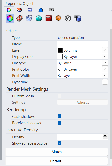

Im having issues accessing the colour of my materials on rhino. I never had this issue before and then suddenly one day my Rhino just removed this setting and I don’t know how to get it back.
In the layer section I tried to assign a material and change its rendered colour however i don’t have the setting to edit the colour of the object in the layer.
Hello- there are two more “renderer development kit” plug-ins that also need to be loaded - I think filtering from the search box at the top right will find those.
