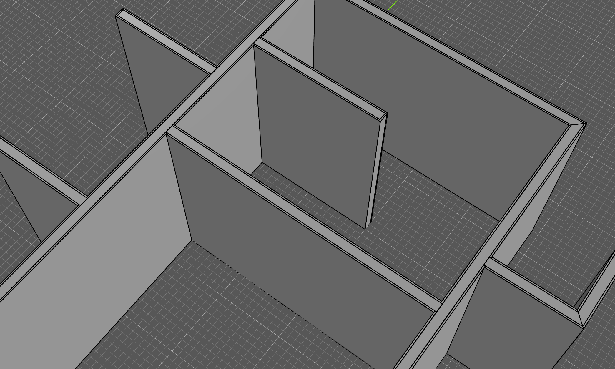

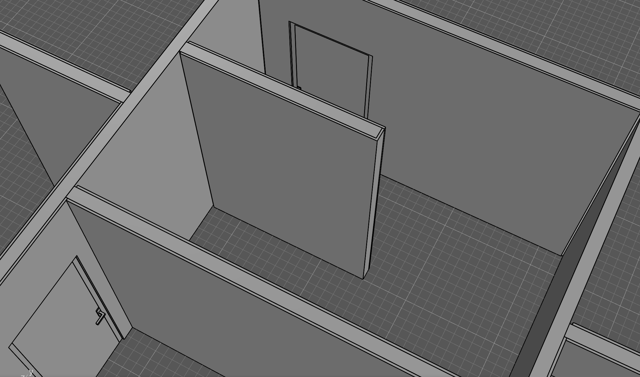

I’m new in rhino and visualarq (started with VA3).
When I draw walls, in the example with just 3 layers, they usually join well and show all layers. Starting to introduce openings there are some layers disappearing.
Is this a bug or am I missing something?

Another situation with a missing layer in a wall with intersecting columns.
Is there a solution?
Please see attached file.

I was able to reproduce the issue you mentioned with the wall layers disappearing when adding openings in VA 3.4 (Rhino 8). It definitely looks like something’s not working as it should.
We’ve reported this bug in our tracker so our development team can take a closer look.
We’ll let you know as soon as it’s been fixed.

Hi @José1,
I’m glad to inform you these issues have been solved in VisualARQ 3.4.3 version, which is already available to download: VisualARQ 3 - Version 3.4.3 released
