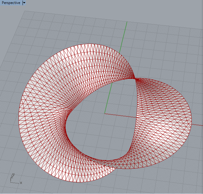

Torus Knots… no volume but fun to play with.
I’m relying on the pFrame component to orient the ribbon surface around the torus knot curve and this might not be correct.
TORUS_KNOT.gh (21.5 KB)

Does anyone know if the ribbon surface is correctly generated? If you look up the different torus knots generated from different p and q combinations this def seems to create the right curve but the surface doesn’t always look right.

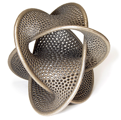

Take a look at the work of Bathsheba Grossman and Rinus Roelofs for just 2 examples, both sculptors, and both long time users of Rhino and 3d printing. Grossman in particular I think was an early pioneer of 3d printed sculpture, long before such easy mail order services as Shapeways existed.
Borromean Rings Seifert Surface, Bathsheba Grossman

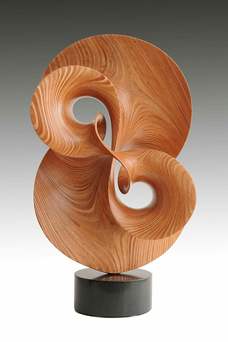

Another of my favourites is Robert Longhurst, who works by hand, but shows a strong mathematical influence.
Arabesque XLII, Robert Longhurst
