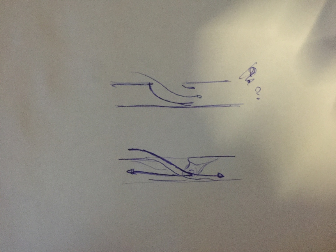

Hey,
I am now trying to make something like this. I am most interested in making those ‘swirl connections’ wherein the bottom floor and the floor above become connected.
I cannot find a workflow of how to do it. Do you might have an idea?

I wonder if you could define some basic shapes, and then use curve offset and between functions to get those parallel lines.
Perhaps also, you could draw/define curves that would be projected or pulled onto the surface. Depending on the shape, these might be lofted.
Topology-wise, I would try to figure out if it’s really a single surface, with two holes, stretched through.
It’s kind of like a topomap.
Or the Belgian Waffle from Burning Man

I could use that twix in between the two surfaces and cutting a hole with it somehow. It will make the surfaces connected and at the same time create a by-pass from platform one to platform two.

I cannot understand how they made the hole. Do you might know?
problem soap bubble 04.gh (11.3 KB)
Hole was formed due to kangaroo mesh relaxation. I request @DanielPiker to help on this
