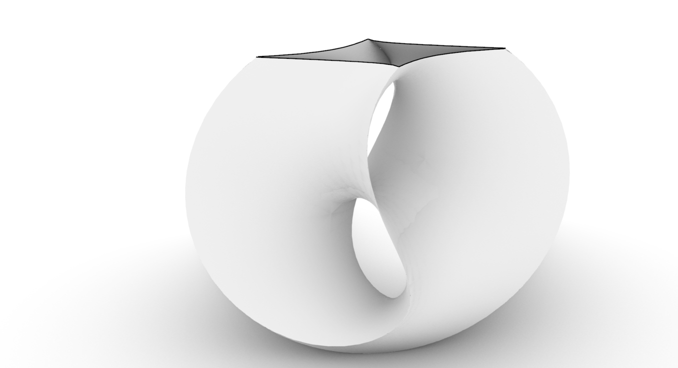

I was tring to figure it out too! What I think a good starting point could be something like this one
This starting with NURBS and trasforming it in meshes

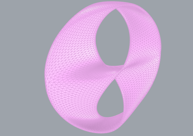

Wao really good! Now i understood the meaning of infinite toroid loop!! Do you guys know a good book or website where to get the basis of this argoument? Because with kangaroo I was trying to use the soapfilm component with the real basic shapes for mesh relaxation and is working, but I see that there are really complex shapes and maybe studying the original shape where they generate could be interesting
I was trying with this before going to try the sketch I uploaded before:

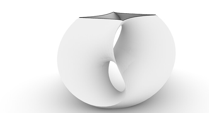

Also - I did finally figure out what was the topology of the sculpture in the first post.
It’s really 2 separate surfaces joined to enclose a volume, neither of which have a trefoil knot as a boundary, so I think the description is actually misleading.
One surface has a tunnel connecting a pair of apostrophe shaped curves.
(the first 2 images show the base mesh I modelled for this and its subdivision, with the ends separated for clarity, though later these ends are brought together so they partly overlap (3rd image) and the mesh relaxed.
Then the other surface is just a copy of the first rotated half a turn.
Finally these are joined together to enclose a volume. The exact boundary curves used won’t be exactly the same, and the tips could use a little cleanup, but I think you’ll agree it matches the topology of the sculpture.

Thanks for the explanation Daniel! But reading again your posts I don’t understand why you think the first figure you got wasn’t right? I mean the construction process looks to me more correct in the first example you made! Sorry if I asked again…
The first surface had zero thickness whereas the last solution has volume.
The sculpture seems to be a minimal surface but with volume

Like I showed above - I believe the original sculpture is easier understood not as simply a single surface thickened, but rather 2 surfaces enclosing a volume
That’s what gives it this circular crease.
