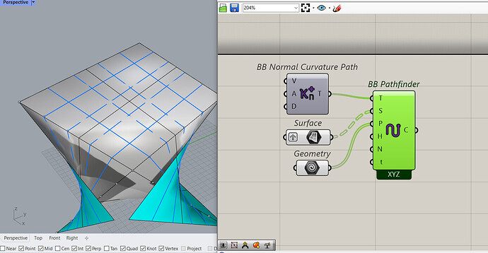

As mentioned in the thread you linked, they(Eike and team) use Bowerbird for the generation of the asymptotic curves, which works over surfaces.
Another post I found seems also to work only over surfaces:
link: Sam Whitehead – WeWantToLearn.net
For my case tried to get the asymptotic curves for the surfaces and they seem to align with the isocurve direction:
That was why I thought I could just subdivide the mesh.
