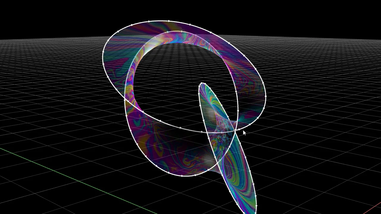

Kangaroo can generate real minimal surfaces!
You just have to use the SoapFilm goal instead of Length goals on the mesh edges. This properly weights the edges by the area to give discrete minimal surfaces, like described in the classic reference by Pinkall and Polthier.
There’s an example file here:
Also if you want your soap film to be able to undergo very large deformations, then you can even use the LiveSoap component, which modifies the mesh connectivity as it relaxes to maintain good triangle quality:
