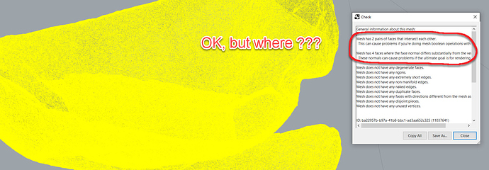

Apart from its clunky ill-designed interface, mesh repair doesn’t highlight the issues in the model which makes manual repair impossible.
That is sad because automatic repair doesn’t work here :
Self intersecting faces are very hard to find. You could try this experimental command here:
TestHighlightSelfIntersectingFacePairs
Does that allow you to Zoom in on the highlighted objects? Might that be a good command to make public?
I assumed that if an algorithm KNOWS there are intersecting faces, it also knows which ones they are.
And how about this “face normals” thing ? Is that also hard to identify and highlight ?
The “Repair mesh” interface is by far the lousiest interface I’ve seen in a long time ; never knowing if one should press “Next” or “Repair” ; lot’s of verbosity, very little useful, visual cues.
The “TestHighlightSelfIntersectingFacePairs” command worked in the case of my mesh.
