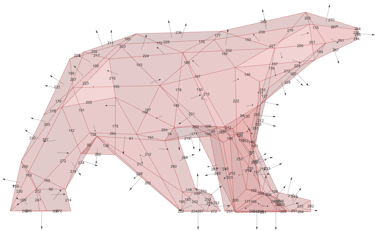

Mesh entities- Ngon problem
Yeah, it gets really confusing and if you ever intend to actually manufacture this then you need a really good system for identifying panels, panel orientations and curvature.
Perhaps there is a way to flag pairs of mesh faces as being concave or convex so you can apply a condition like IF CONCAVE THEN ANGLE = (180 - ANGLE)
I made an update to NGon plugin that allows to get these values directly for polygonal meshes including triangles, quads, hexagons and etc:
Be aware that for open meshes, the orientation of mesh matters.
Sometimes you need this information sometimes not.
If you do not need it then you can take modulus of 180.
I updated current version of NGon (3.0.0) that includes this property:
Example File
Sample.gh (19.6 KB)
This is with your file:
For sure this angle notation makes sense when polygons are planar or at least close to planar.

I thought I would add this old school arc method I arrived at in the ye olden days.

I have just noticed that the some of the quads are not planar in my bear mesh. I thought it is high time to try some of the planarize functions. I cut out a portion from the bear for experimenting. I had no success. Even if I am playing with the RUN and Reset booleans, nothing happens. Actually it worked for the very first time and the counter displayed a value but then I changed the iterations and since then I cannot run it again.
PLANRIZE.gh (9.0 KB)
The polygons can also be simply planarized like this:
planarize_bear.gh (14.1 KB)
thank you!
