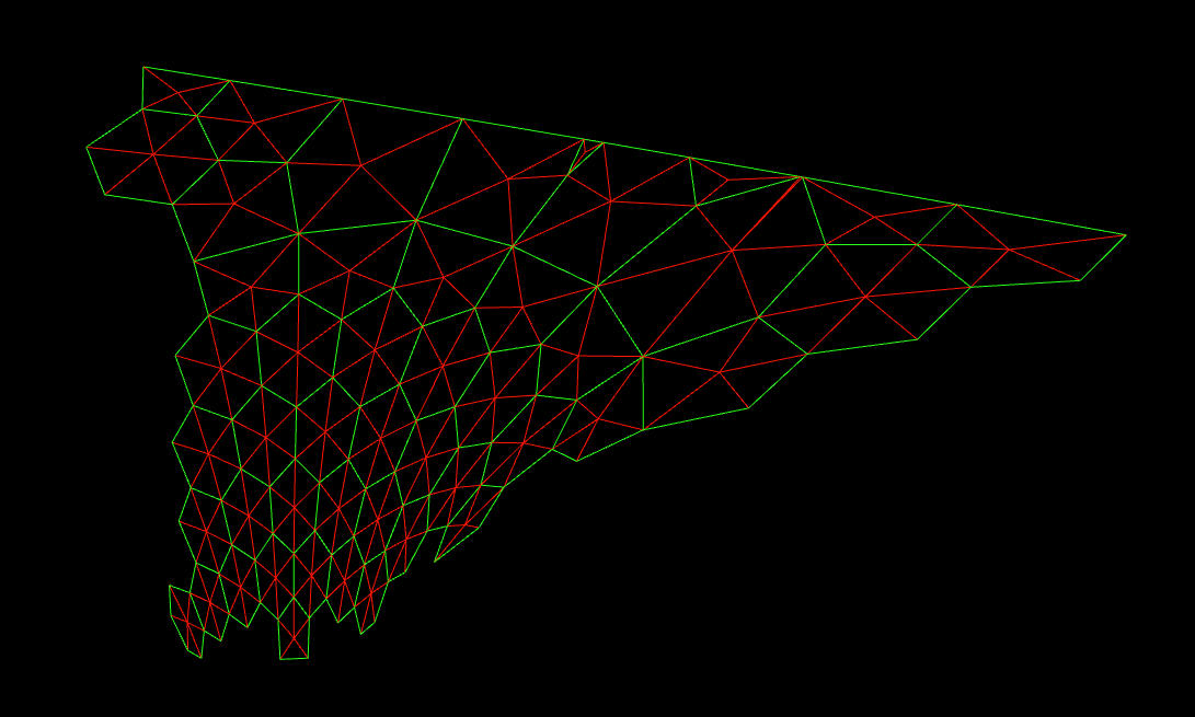

And this is the kind of mesh I am getting after trying various methods:

I need the vertex normals, face normals, and neighbouring vertices. I tried getting the neighbours, but it always gives me the triangulated mesh neighbours.
What I tried doing is using the centre of the polyline and then getting a normal from that point. This is getting really heavy really fast and doesn’t feel like the right direction. What kind of method would you suggest?

I think I figured out how to do it.
Another good samaritan on this forum had posted a python script on how to create closed polylines from a network of closed curves:
I used that in combination with the Ngon mesh creator. The only part I am not completely happy about is the way I am getting the face normals. Though this has solved my problem, I don’t know if there is a more elegant way to achieve the same.
Is this one of the methods you were talking about @DanielPiker? I have basically taken all the vertex normals of a the polyline boundary, and created an average normal that is at the centre of the polyline.
