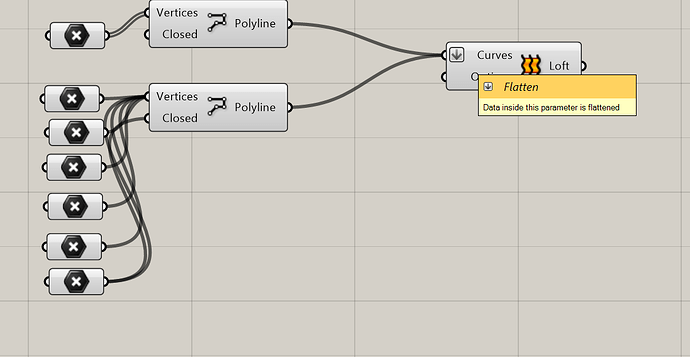

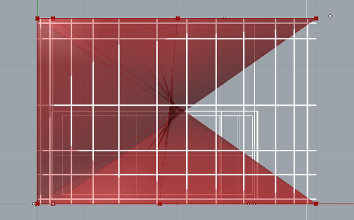

I’m trying to loft two surfaces together but it’s not working and the surfaces become warped. It worked before, hence the baked geometry, but I must have accidentally deleted a point because it stopped working. I redrew the polyline, but to no avail. I’ve flattened the C input and ticked align on the loft options.
Hey Fernando,
Unfortunately the two curves aren’t exactly the same shape, I’ve redrawn the polylines and this time the message ‘loft could not be constructed’ shows up…
please internalize any Geometry (right click on each and all Parameters that carry Rhino-referenced geometries and choose internalise data ) then save your GH file and post it
