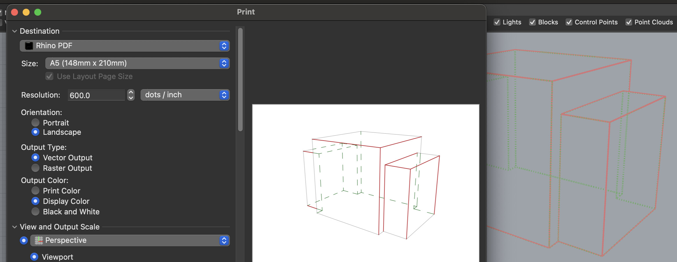

In Rhino 8, hidden lines use the Hidden linetype when a view in a technical display mode is printed to vector.
You have your linetype set as follows:
When I import your PDF file into Rhino and measure the segments of a hidden line, I get this:
That appears to be working as expected.

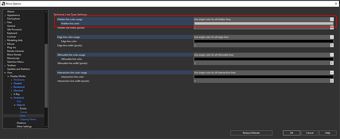

Additionally, is there any way to control the color of printed vector hidden lines? In previous R8 releases (8.10.24228.13001), this was possible by changing this setting:
But now, it seems it only works printing in raster, which is not ideal.
For example, this is how a printed drawing used to look, controlling the color of the hidden lines:
this is the same drawing, same geometry, but recent release:
Clearly the previous shows hierarchy between hidden/visible whereas the latter gets very muddy with all the line work being black.

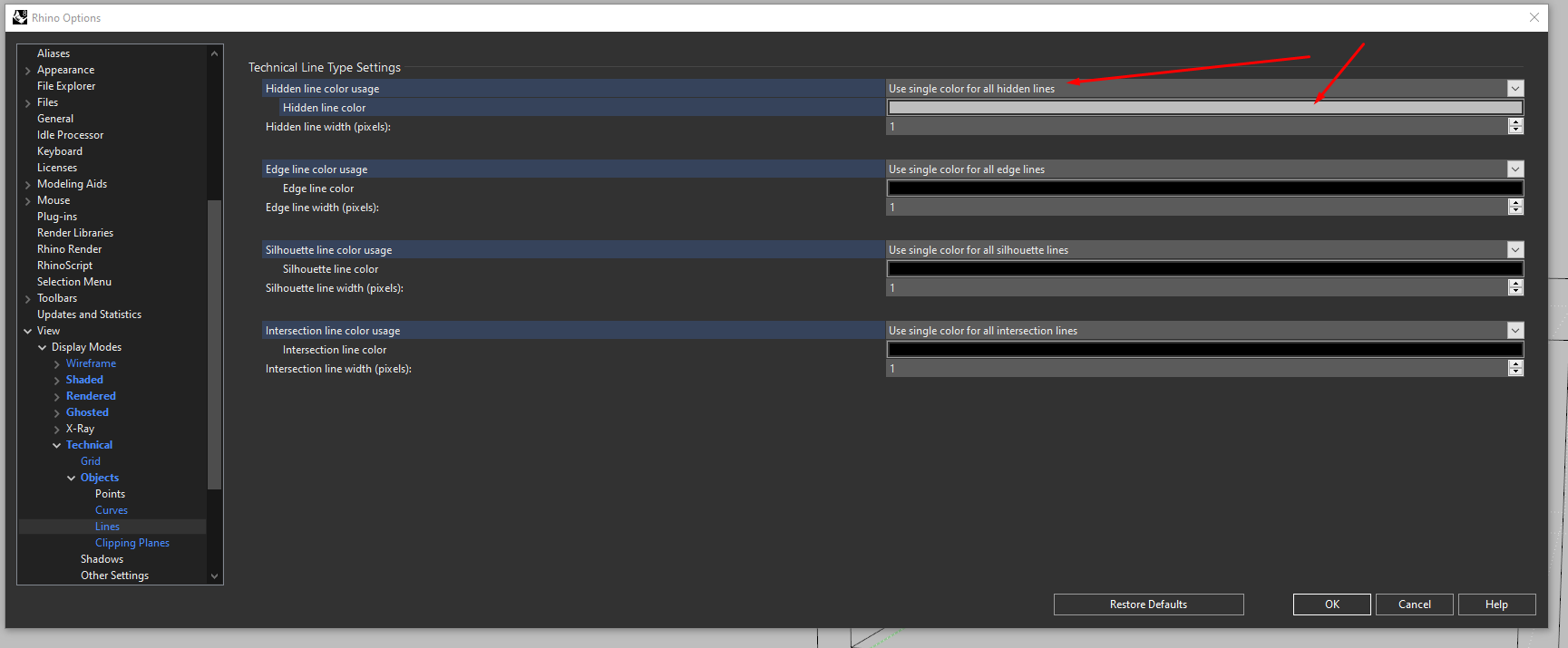

I noticed that you have your Output Color set as “Display Color,” whereas the functionality should also be in “Print Color”. In my workflow, I use bright colors for layer color coding, but I only print in black linework and use limited greys to reduce the busyness of the drawing:

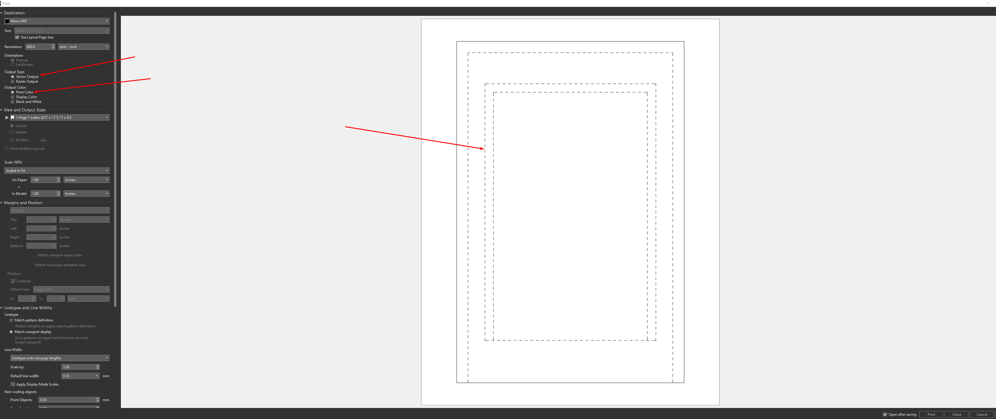

Vector toggle:
Raster toggle:

I don’t mess much with print colors so I’m probably just not seeing something… In the file that you posted, there are two objects and a detail. All are on the “Default” layer that has its print color set to black and none of the objects have individual overrides. Given this, where does the difference in print color in raster come from?
It’s coming from this override:
Those only influence the display color and will only be used when printing using those display colors.
I understand. It seems I’m relying too much on a bug. Perhaps I need to rephrase my initial question: Is there a way to independently change the print color of hidden lines, similar to how you did in “display color”?
