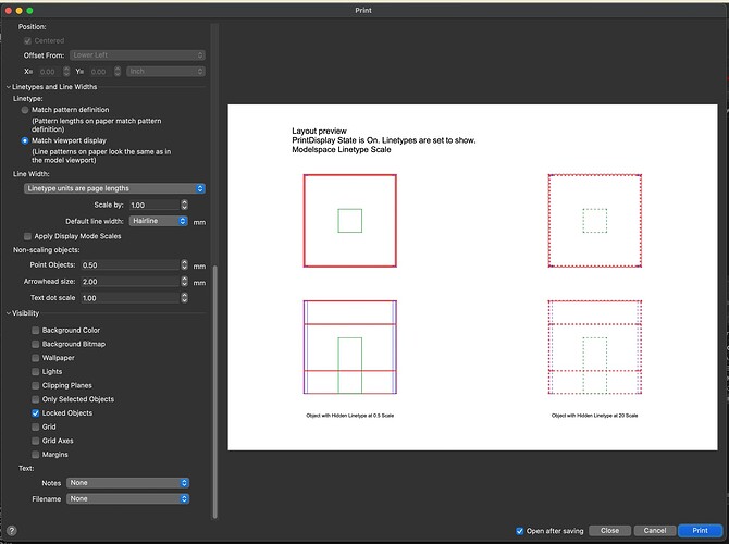

I wish for the linetype scales in my Layouts, at least when PrintDisplay is turned on, to actually accurately depict what will print. Currently it does not.

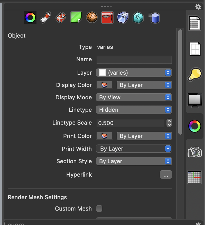

I am simply selecting the geometry, and changing the linetype on the items rather than by their layers. Let me know if By Layer would yield a different result. I completely understand that when in the model space, if my linetype was say 2.0mm, 2.0mm I would need to increase the linetype model space scale to make this useful. I don’t think this is the issue.

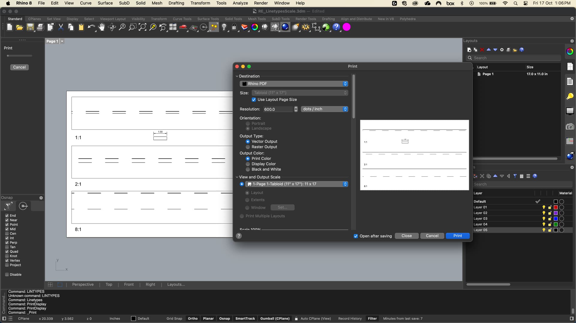

However, when in a detail on a layout, I would expect the linetypes to be 2mm,2mm on the paper regardless of the model scale. And that’s what shows (see my screenshot labelled 5.) however, when I actually open the print PDF dialog box (6. & 7.) I can already see that the model space linetype scale is what is printing. So the solution is I have to scale up the linotypes to be huge (say 20 scale), which would be ok-ish kinda, because perhaps I could logically infer that the viewport is showing the model and therefore the model space linetype scales, but they still don’t display accurately on the layout anyway so it’s useless. I can’t see how my drawing looks until I print it.

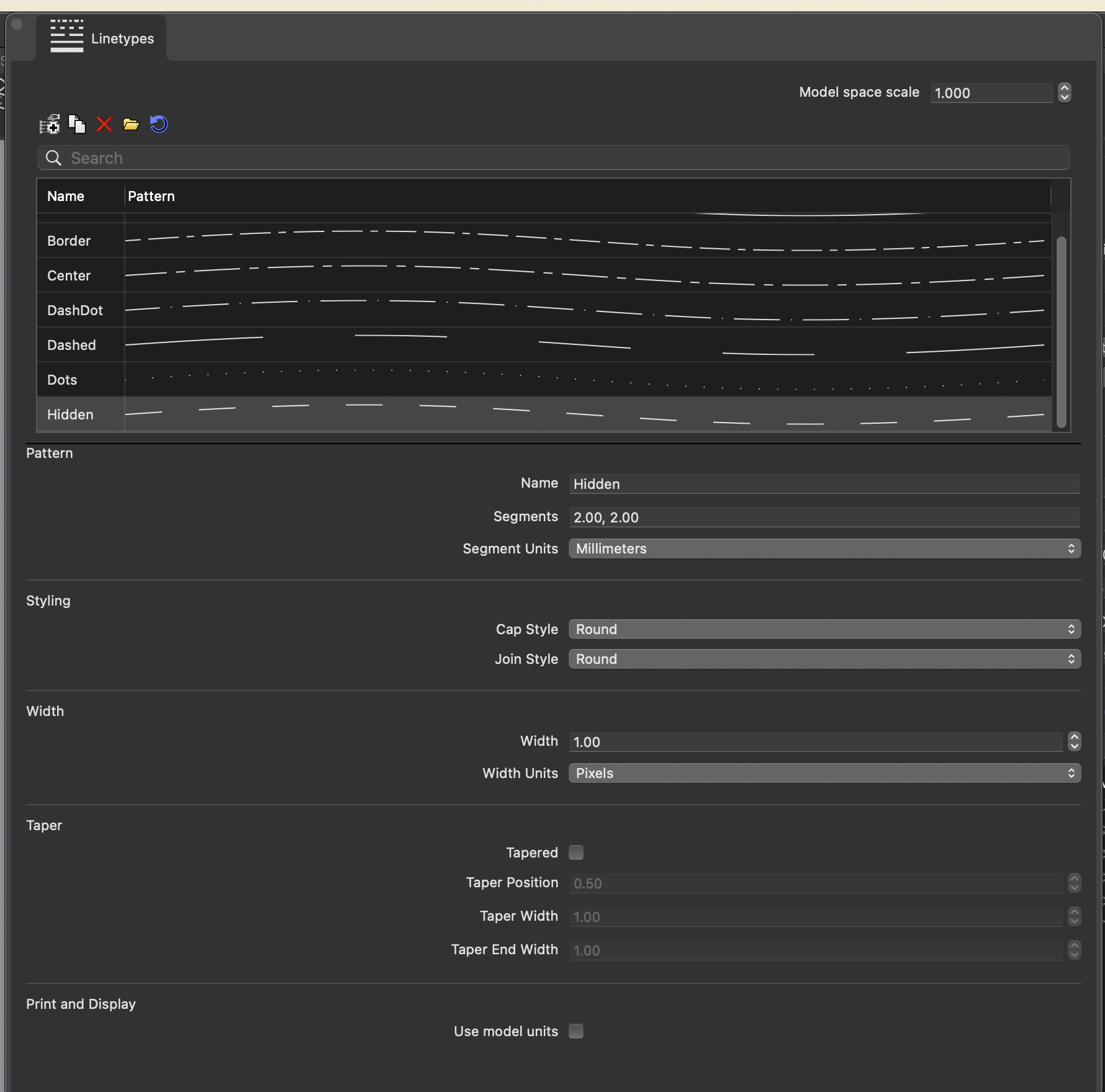

I have tried very option on and off in the print dialogue on the screenshots 6&7 provided. I have also tried checking the “use model units” box under the “print and Display” section of the linotypes panel (in screenshot 3) but it seems to do nothing.

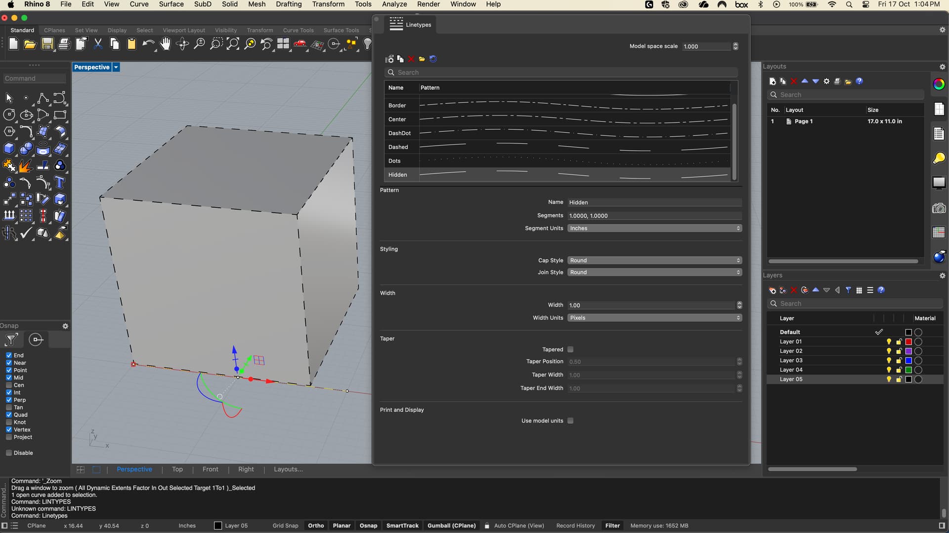

  1. Shaded View Modelspace:
  1. Wireframe View Modelspace:
  1. Linetypes Settings Panel:
  1. Object Properties Panel example (to show linetype)

Here i changed the linetype units to the units of the file (vs pixels)
The details are at different scales and the linetype maintains its size in the layout.

Here is the layout (looks great - they match). And then the print pop-up (already you can see the layout preview and the pdf will diverge from each other)

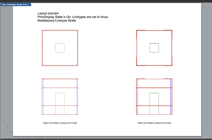

And finally a screenshot of the PDF exported in acrobat. Looks nothing like the preview on the layout page. THIS is what I have an issue with.

Thanks Alice, I’m seeing this as well when printing to vector. I found a similar bug report ( RH-86196) and added this thread.
