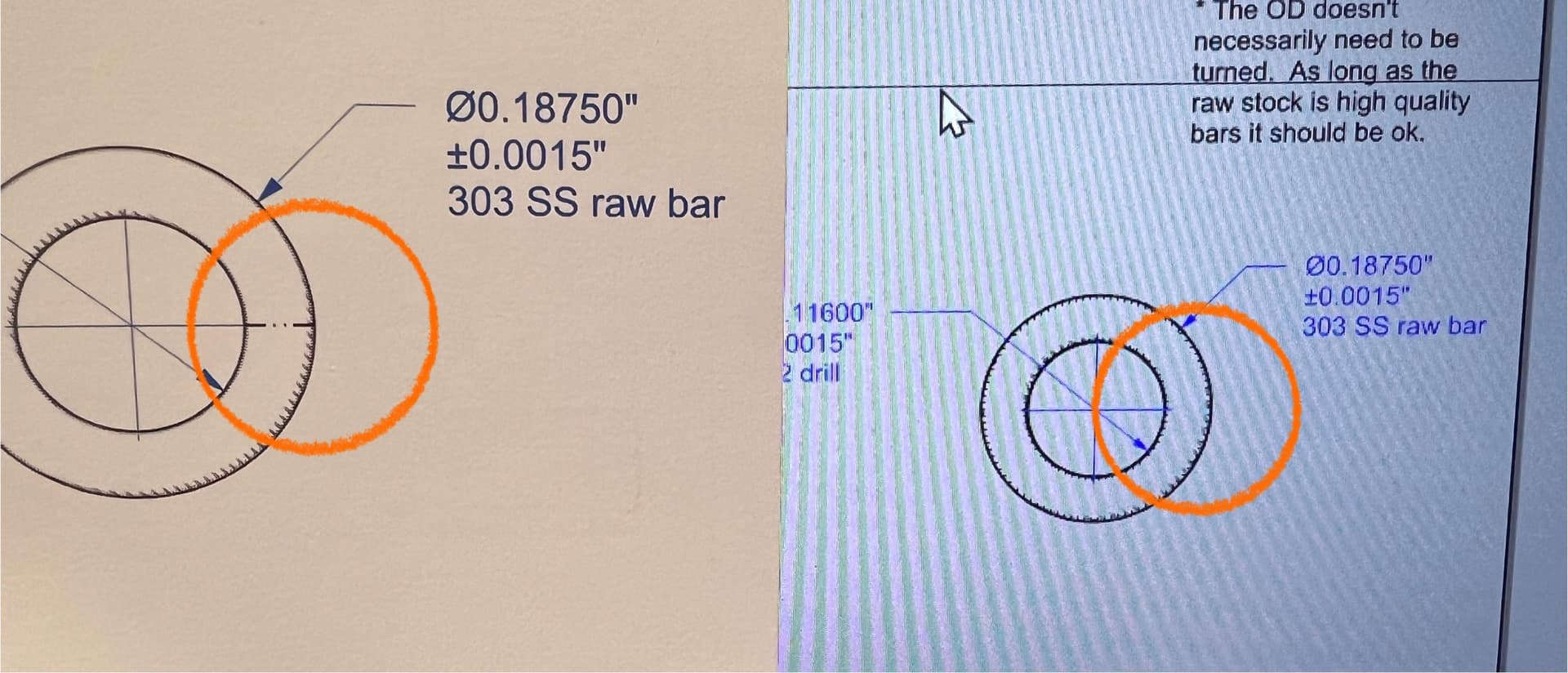

There are a number of problems here I would like to record. The problem is that they are display and resolution dependent, so they are hard to duplicate exactly.
In this last example I see a number of differences:
  1. Shadows are different spacing. This is a direct resultion difference from display to printing. Not that it is correct, it is just what is causing it.
  2. Is the line work different/missing in the middle of the orange circle?
Can you systeminfo in Rhino so we can see the exact Rhino 8 version being used?
The image on the right was photo of the screen, image on the left was paper print from the data shown on screen.
I’ll try to do a screen shot so that image is more clear in the future.
The line work should be the same.
I think, imo, what might be happening is the print is grabbing a ‘crease’ mark from the seam while it doesn’t appear on the object in the workspace, the print embodies it for some reason – I could be wrong.
