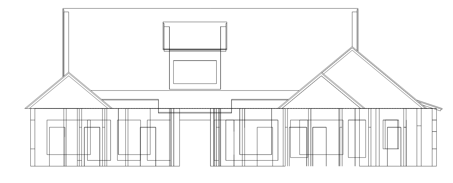

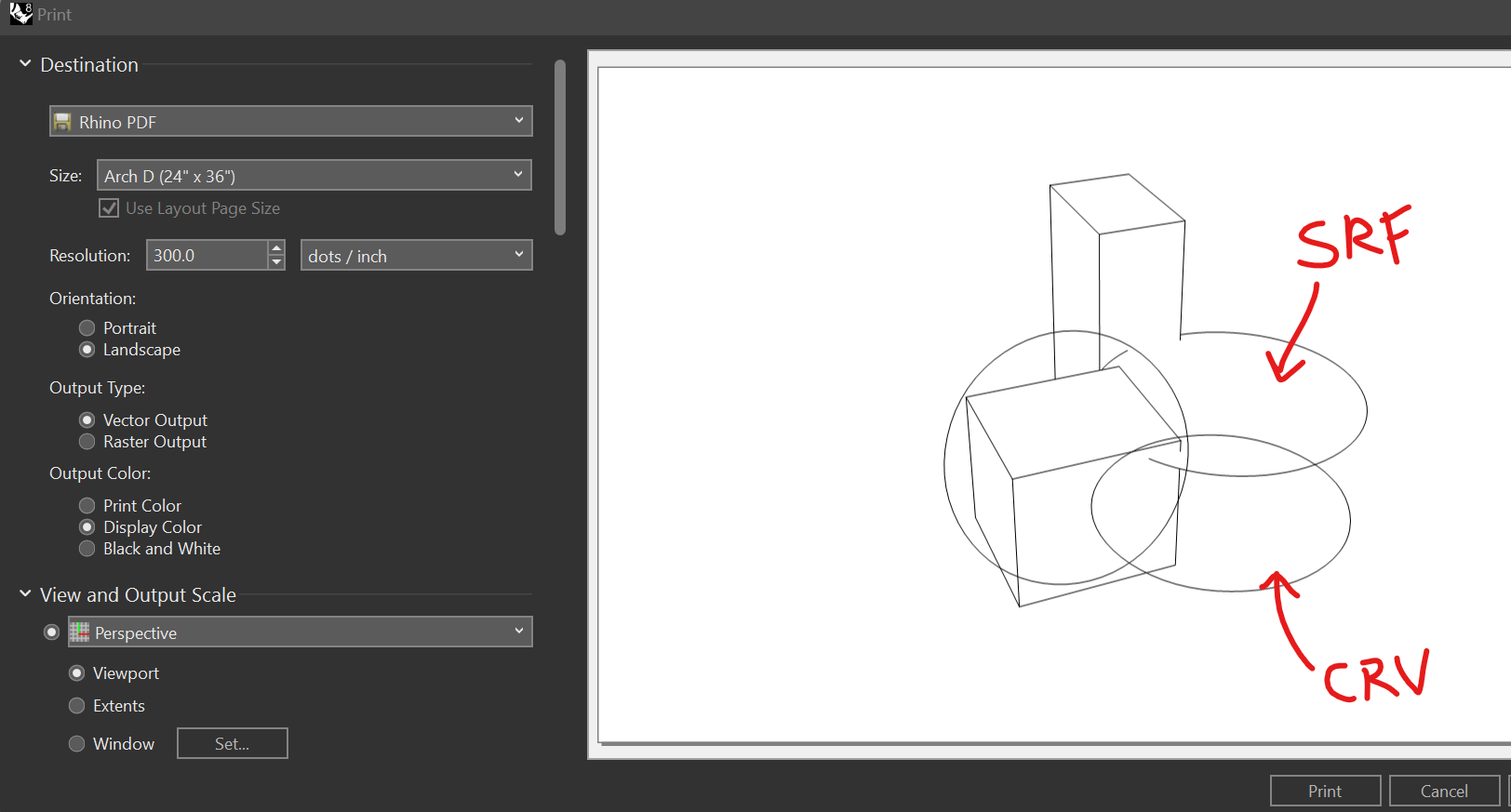

@stevebaer and @Gijs , do you see this on your end with the attached test file and Default Technical Display Mode with hidden lines turned off?
EDIT:
Surfaces with edges appear to be occluding correctly. It appears to be directly related to curves and leader objects
Shaded View:
Technical View (Vector Print Preview):

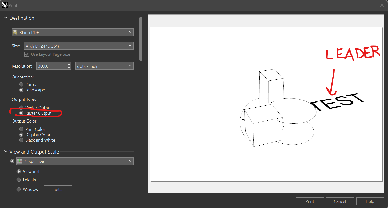

Leaders also cause issue:

Hi Michael -
If you ask me, those are two completely different issues.
But, yes, I’ve been meaning to file this one for the past few months now, so, thanks!
→ RH-79091 Print: Technical mode with HLR does not clip curves
As for that first one in this thread, I can see the same in your file but I can’t reproduce that from scratch. Also, as you say, when you simply create a new detail, this doesn’t happen anymore. Additionally, this isn’t even limited to technical viewports, I see the same in your file when I set those details to Shaded and Rendered (with edges shown):
Simply unlocking those details, making them active, zooming to extents and then zooming back into the area you want, clears this up (done with that upper detail in the following picture).

Also regarding the YouTrack I think it is worth noting that Leader objects are not properly occluded either. I haven’t tested with dimensions or other annotation objects but Curves and Leaders both do not occlude in the Technical Display mode when Vector output is set.

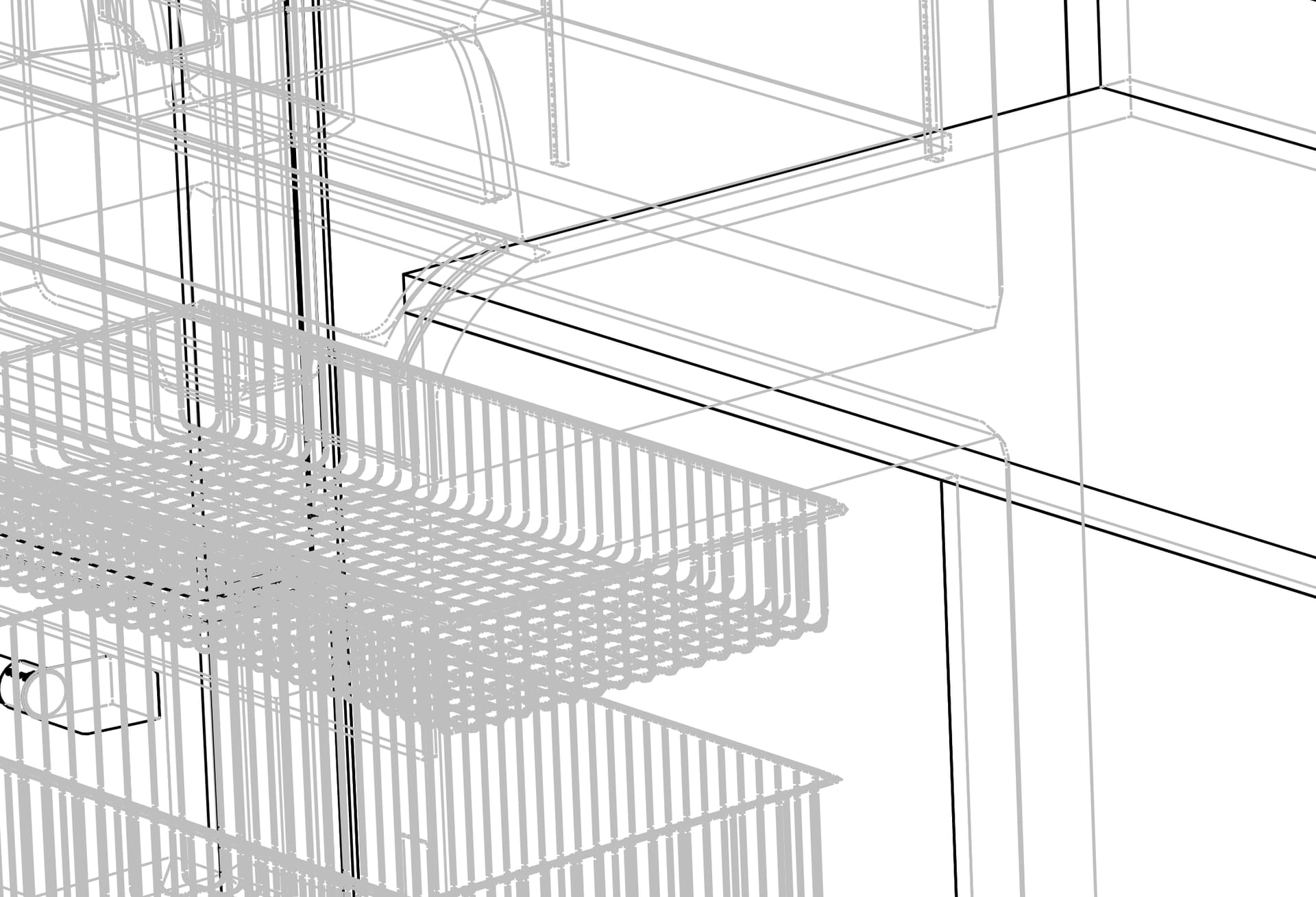

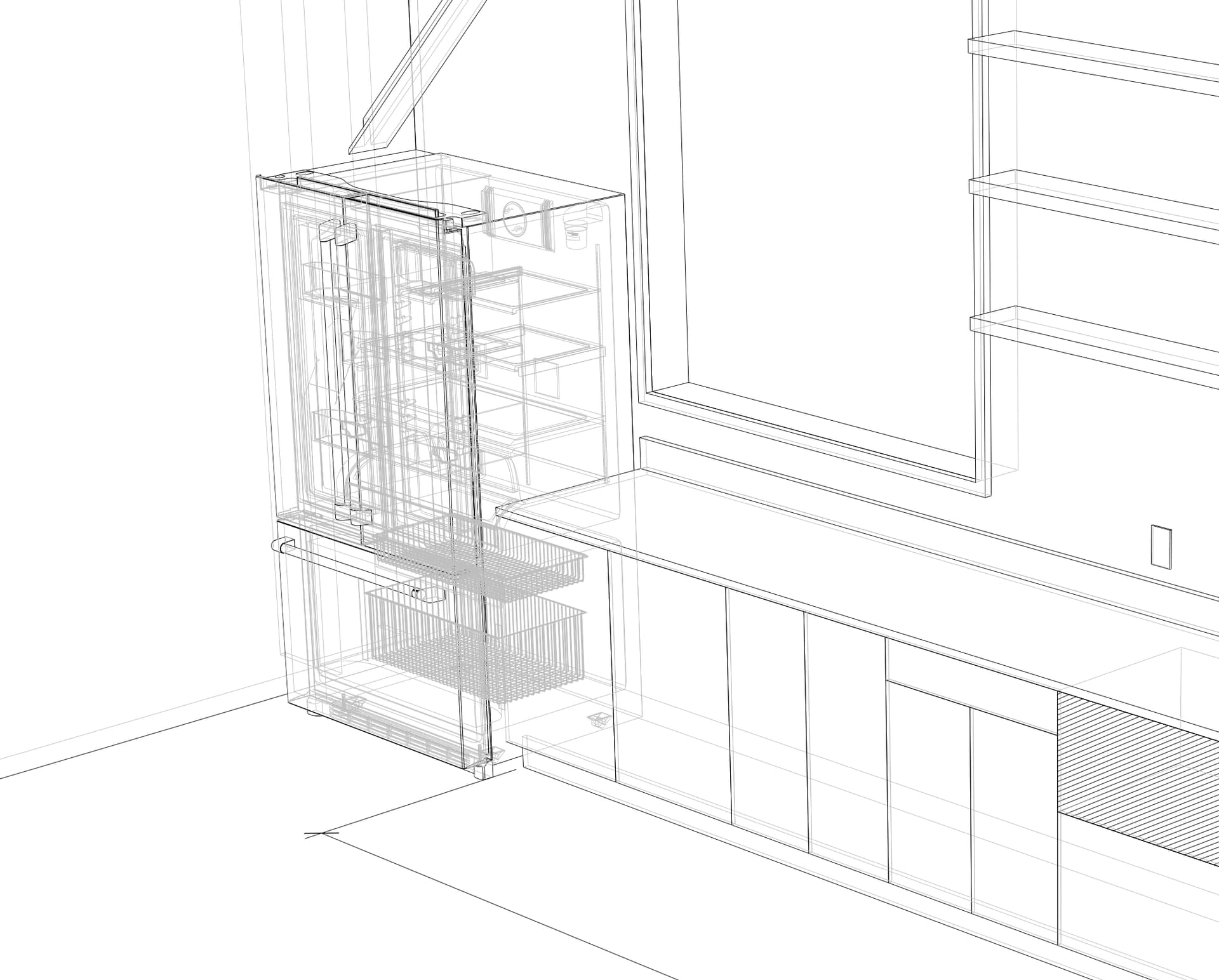

Chiming in here – having read through the thread, I thought I might be able to offer an example that at least clearly shows part of the problem, namely hidden lines “showing through” in technical view. I’ve also noticed that in some cases, exterior (non-hidden) lines are being incorrectly rendered as “hidden”:
No grasshopper, no python here. The fridge is a mesh, everything else is nurbs. Display mode is Technical with the lineweights and colors modified slightly (hidden lines in grey).
Model view:
Layout/detail view:
Printed/exported PDF view:
Here’s a closeup to show what’s happening – the hidden lines are being rendered “above” the rest, and the corner edge of the cabinet should be black, but isn’t:
