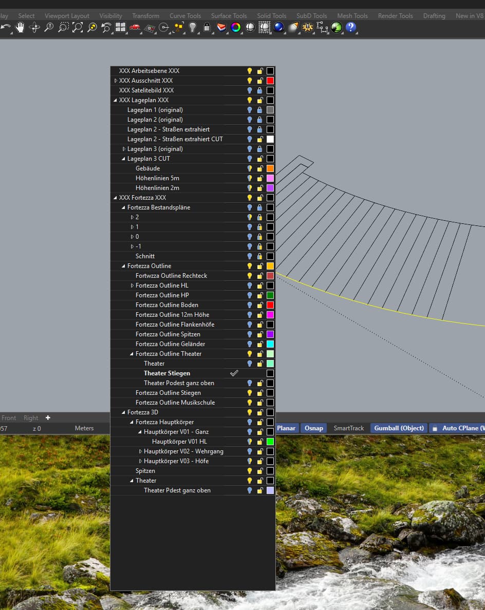

Hi everyone,
I’m using Rhino 8 on Windows 11 with an Ultrawide Full HD monitor. When I try to assign objects to different layers, the layer selection panel drops down but extends below the Rhino window, making the lower layers inaccessible. This happens both in fullscreen and windowed modes. Any suggestions? Thanks a lot!
Hi Aughul -
Please run the Rhino SystemInfo command and copy-paste the result here.

Hey @Aughul - SR14 was released last you. Can you please give it a go?
— Dale
It worked! Thanks a lot!
