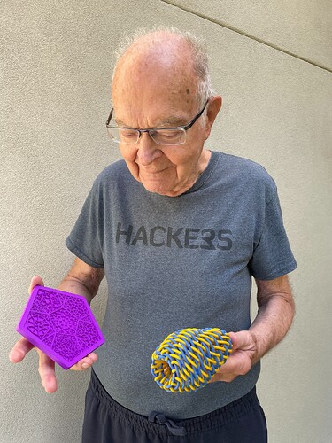

Sorry to bring up this thread again, but this made my day:
Klein bottles are pretty sweet. I’m glad to find this thread again. :beers:
This type of geometry is on my mind from time to time. Someday I hope to experiment with vacuum molding processing using similar theories to see of any advantages molding things upside down in a vacuum. :slightly_smiling_face: Not sure it’ll work but sounds cool.
