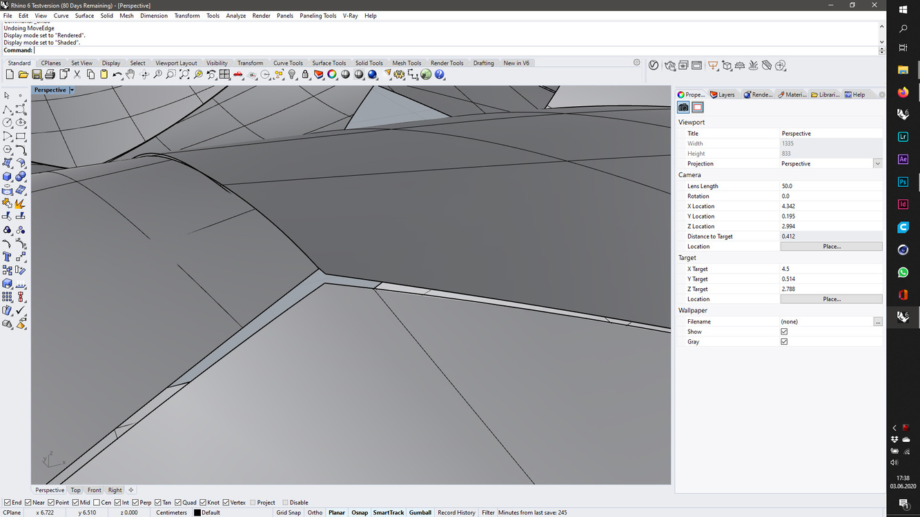

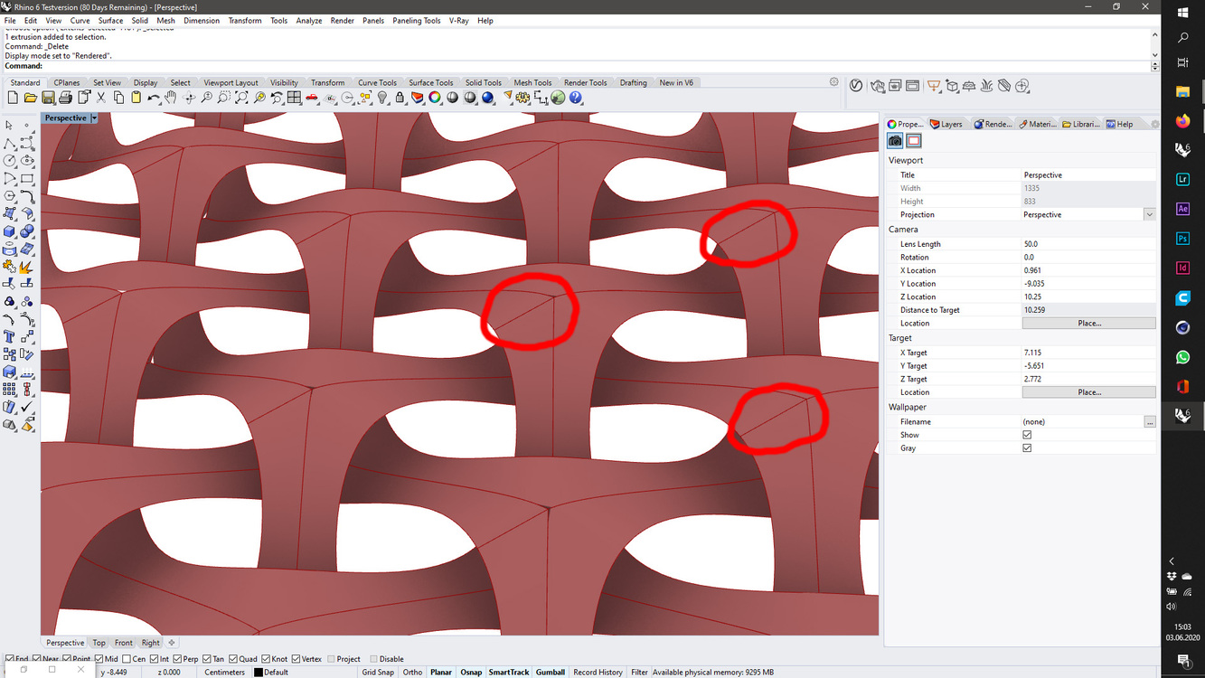

Hey Guys, im desperatly trying to get a fix on my Triple Hexagon Weave. In general my definition works for what its supposed to do. A triple hexagon weave with individualy adjustable modul perforation and height for multi objective optimisations with ladybug and Octopus. Its for an architectural Project in my studies and will turn into a lightweight fabric structure at the end. But there are some little nasty edges that i cant get rid of. I marked them on one of the Pictures. I think part of the Problem is that i am creating a ruled surface between a closed and a periodic curve. Is there any possibility to get a closed curve periodic without loosing its form. Would be great if someone could give me a hint or even has a total different approach that i could follow. Many thanks in advance from Frankfurt, Germany. Sandro

Try to make a surface from patch and split the inner side. However this option is not a good solution for optimization since it’s heavy to compute.
Thanks alot, this approach fixes the edge problem but leads to an inaccuracy between the surfaces. Ill keep on trying

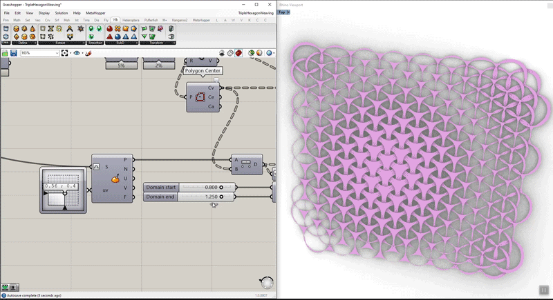

Why not using Mesh instead?
TripleHexagonWeaving.gh (29.4 KB)
Thank you so much. This is solving my problems. Great Job sir!
