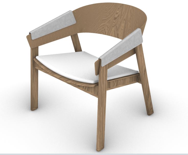

Hi all, I’ve downloaded a mesh chair model and need to add textures to it. Unfortunately, the surfaces have lots of facets. Is there a way to avoid fragmentation and adjust the UV mapping for a smoother texture application?
Unwrap won’t work because there is no seam to be selected (the edges are too fragmented). also tried custom mapping and box mapping, but neither works.
Has anyone else faced a similar problem, and if so, how did you work around it? Any advice would be greatly appreciated.

First off, that’s a well shitty model! I’ve refined the mesh on the arm rests and upholstry - just to make the roundings rounder :slight_smile: If you need it for a close up, I’d re-model the whole thing. If it’s just for background, here’s how I’d do it:
  1. Make sure normals are pointing out (all but one object have their normals pointing inwards)
  2. Weld everything up (200 degrees)
  3. Apply box mapping where it makes sense
  4. Manually unwrap more complex objects (in this case, the back)
    BTW UV-Unwrapping/editing in V8 is fubar’ed, so this was done in V7.
    question_JN.3dm (8.4 MB)
    HTH, Jakob

here’s a different approach, not modifying any geometry, nor selecting edges, nor remeshing – just opening the file and applying spherical & cylindrical projections to the different pieces:
if the piece is the main focus of the image, probably best to use the other suggested approaches, but if it is just one of a hundred pieces of furniture in a setting, a two minute solution like this may get the job done

Thanks jdhill. That looks surprisingly good! We tried box projection previously without selecting individual pieces and failed. We will give this a try :grinning:
