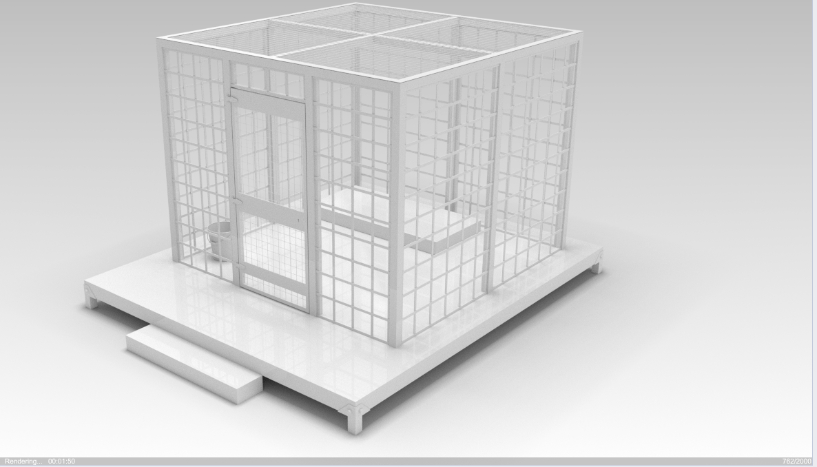

Sorry about this delay Pascal. It got very busy at work suddenly and I didn’t have a moment. I just know from having used keyshot, that right off the bat, when importing a model and applying a matte white paint to everything, it creates a wonderful ambient occlussion. See example film set cage. The first is the rhino raytrace version and the second is the keyshot. I like how keyshot renders soft shadows, giving it definition. How would you go about getting a similar result in rhino?

Hi Peter - yeah… advantages either way in your first two - the KS one is floating, for one thing, but then the contrast & shadowing in the details is noticeably better… KS does use a slightly reflective material, it would be interesting to see the Cycles one with such a material applied rather than just plaster.
Still on the flat side I guess…

I noticed that too after posting. Looks better. But yes, the ks creates a better separation between elements.
What are your settings for this look?
I changed my render backdrop to gradient and ground plane to “show shadow only” and material is a white plastic with 100% reflectivity and about 75% clarity… it’s actually looking much better… but I noticed that what really determines the look, is what specific upper color on the gradient I use. If I make it dark, the whole model looks too dark…and conversely, if I make it a lighter gray, the model ends up looking too white. Then thru trial and error I found that by changing skylight to “use custom environment” and selecting a studio hdri, I was able to keep a gradient on the background while applying a lighting effect to the model. And by changing the intensity, I was able to make it brighter without affecting the background gradient. Not a pleasant journey. It’s better now but I had to get rid of my materials/textures and change them to white plastic…so to get this nice clean occlussion look, it’s problematic as I have to create two models–one with my materials and another with just white. Ill have to test it with other models to see if it creates the same look. BTW: is it possible to save this “look” so I can easily apply it to my other models without having to go through all the steps again?

Hi Peter, well done! You came a long way. But the raytraced and the rendered view was quite far apart appearance vice. So I made a copy of the Raytraced display mode and altered the material setting to use a custom material for all objects, and sat gradient as background for THAT mode only. It does use the lights in the scene though, so you need to do two steps to get this result:
1 - add a rectangular light the size of the objects at twice the objects height and set the light to 60% intensity.
2 - lower the default environment intensity to 0.6
And you’ll get this result in no time:
Same file just switched to normal Raytraced:
That is the easiest workflow I could manage for you. Basically just two steps though, add and alter light and environment.
You can also save an empty file as a template and then use that to import your models into.
Just open the settings page and navigate to OpenGL and display modes and import this:
Raytraced - WHITE -.ini (11.7 KB)
Thanks, this is a nice solution. Im not crazy about having to make a light and adjusting it, but it’s just one light so not a biggie. I tried your technique and it seems to work nicely. :slight_smile: Will save it in my template file.
