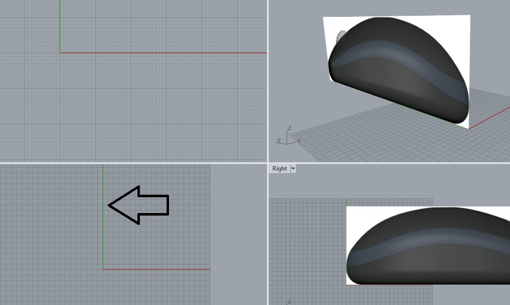

I can't see the image border lines
Hello, does anyone know the solution? It’s very frustrating.
One workaround is to DupBorder the Picture object and group the resulting curve with the Picture.
I need a permanent solution. Thank you for your help.
There isn’t one. Picture edges haven’t been visible edge-on since Rhino V6 - the same with lines viewed end-on. It’s not in V8 either, so it is likely going to stay that way for the time being.

Hi -
In Rhino 5, those edges were drawn in edge-on views.
In later versions of Rhino, those edges are drawn in technical display modes.
It’s Rhino V5. I said as of V6…
