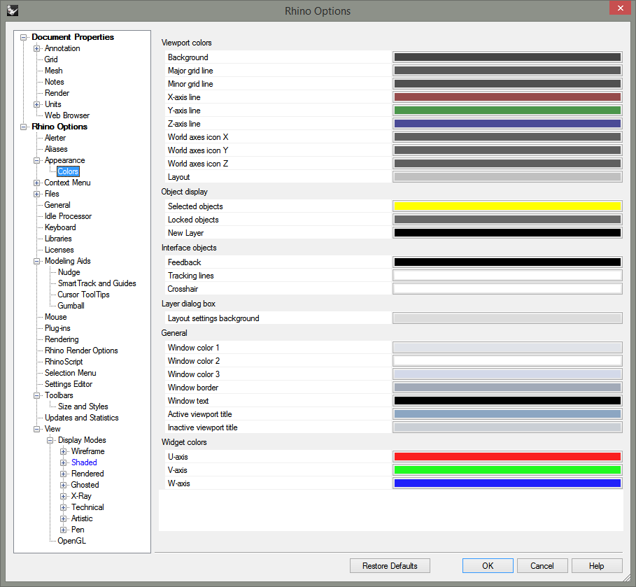

Preferences are application wide settings… if i change something there then that change will be affected in every file
Settings (File-> Settings) are file specific… they only apply to the particular .3dm you’re using at the time.
for example. i can have one file with units set to Meters and another with units set to Feet… each one has it’s own individual settings applied.
if things like that were an application Preference instead of a file setting then all files would be either Meters …or Feet.
(many more examples can be shown regarding the differences between a Preference and a Setting… hopefully the units example makes the point though… and if both app Preferences and file Settings were in the same place-- then-- it would get really confusing .

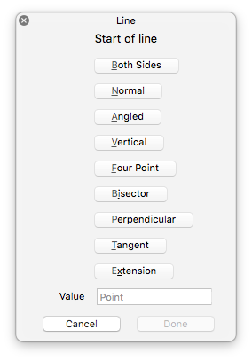

for example, if you run the Line command, you have these options:
so if you find yourself using the Bisector option a lot, you can make a macro for it by writing:
Line Bisector
…and the alias will take you straight to a bisector line instead of needing to choose the option manually.
if there’s something you do which takes 5 steps and you’d like to automate it, make it a macro… look at your command history of those 5 steps and that’s basically what the macro will be written as.

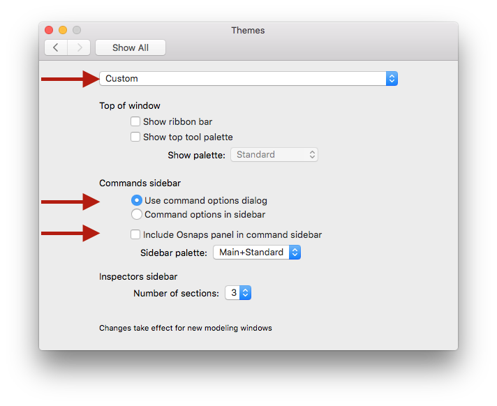

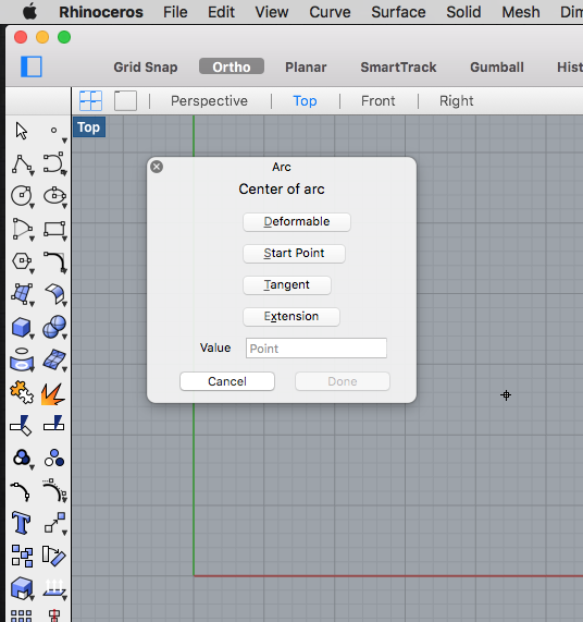

so… if you have either the osnaps or command dialog docked(?) in the left side panel then you’ll be limited to the size you can shrink it too.
(and i imagine your problem with being able to do three rows of icons before… but now get a minimal of 4 rows… has to do with the size you’ve set the icons too… if your icons are smaller now then there will be 4 rows instead of 3)…
anyway… if you go Rhinoceros-> Preferences-> Themes
set it like so:
the command dialog will now pop up on an as needed basis (you can move it around and it will remember it’s position).
the icons can be shrunk down to two rows.
you’ll need to use a different method to set osnaps… theres a button on the top toolbar for viewing osnaps.
i personally mostly use the command ToggleOsnapPanelUnderCursor set to a mouse button… when i press the button, the osnap panel pops up under my cursor position then disappears when i move off the panel.

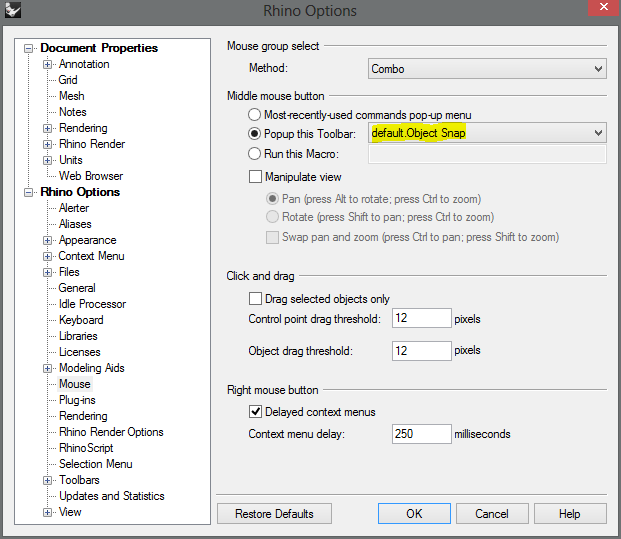

I have this as standard, it’s set in Options>Mouse… --Mitch
I only see 2 commands in Windows that toggle something, one is viewport and toggle render mesh. Doesn’t look good for Windows.
In Windows Rhino, you can popup any toolbar with the macro ! _PopupToolbar "ToolbarName". The toolbar disappears after you click a button. If you want the toolbar to stay out and not disappear, you can use

You set this in Options as above, it’s not a command…
Hmm, rereading this after some much needed coffee, maybe you want the checkbox osnap panel and not the osnap toolbar to pop up under the cursor? In that case, no, it’s not currently possible. All you can currently do is show/hide/toggle visibility with _ShowOsnap.
