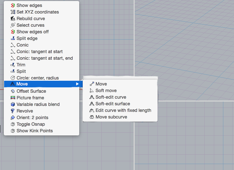

Starting with this, I think when you pull down Rhinoceros only Preferences should be there, Commands & keyboard shortcuts should be in preferences only. No need to access it from 2 places, like here …
or here …
or maybe this … my keyboard went missing lol
It should be that we can move palettes to where we want and even our custom ones.
Also maybe access anything from the right side slide outs from top toolbar by a right-click customize.

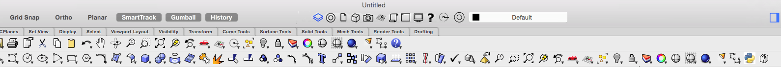

My pet peeve right now is that I cannot move the tabbed palettes in the ribbon bar and cannot dock newly created palettes to the ribbon bar.

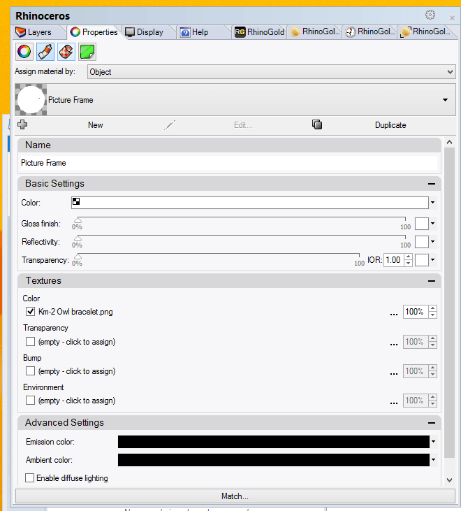

As a side note the need to open the material editor to change Picture Frame transparency is not fun. On windows it can be done like before the new Rhin Render, in the object propertied panel.
I have a drawing / drawings in every model that I am changing transparency through-out the modelling process. Having to open the material editor to change transparency is a time waster.
