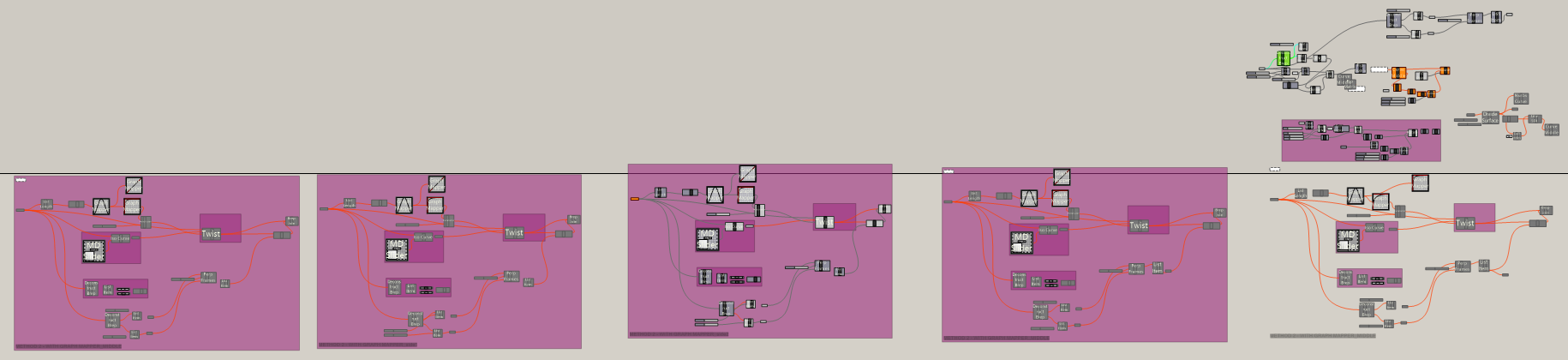

Hello how can I make twisted louvers like these images on the non planar surface that I have using the red curve as an attractor? Thank you so much for anyone who helps or tries to help!

Why? There are ways to do this with standard GH components.
And all this code
All of it canât be relevant?
I have simplified the script but the bottom one is still a reference trial but its not what I want. I have tried using that as a reference and only came to a certain point. Non of those unrecognized objects are needed.

It should be simple but that GH file doesnât look simple to me.

Hello sir I have reuploaded the script, and written what they are underneath each group. The first two are references that I found online I tried to adapt them to what I wanted (which is the last group in the script, named as trial) but I failed to achieve so. I have placed them there so that maybe it can give an idea to people who view itâŠ

[âŠ] Itâs also a good idea to remove everything non-essential from a gh file.
Unused and irrelevant bits should be purged from the GH file instead of expecting people to read everything and decide what is to be ignored. In this case, that turned out to be less that 10%.

Also, a quick look-up takes us to a source of one of your images?
If you snag the example from there and perform some simple tweaks, I bet youâd have something already! Thatâs what I did - low-hanging fruit ![]()
Hereâs an example using what they (Kim) share on that post:
twisted louvers again and again.gh (15.1 KB)
âsubtleâ tweaks highlighted in pink:

Cool - but I think youâre good with that quick example shown in my previous reply - you should be able to integrate into your script and replace assets with your surface and curve. Notify how it goes!
