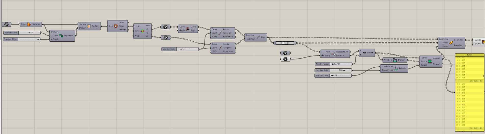

I am new to grasshopper and struggling with generating a louver facade based on a planar or curved surface as input. I managed to get the twisting effect, but i would like to add more options to that. my questions are: how can I define a distance between the single louvers? I want a small gap between each of them. and my second question is how can i change more about the twisting? like using attractor points, so that the pattern looks a bit different and some openings are bigger, others smaller?

like this?
yes, that seems to work quite good! is it also possible to move to attractor to the middle of the surface or to use multiple attractors? thank you :slight_smile:
You can have a look at this thread.
