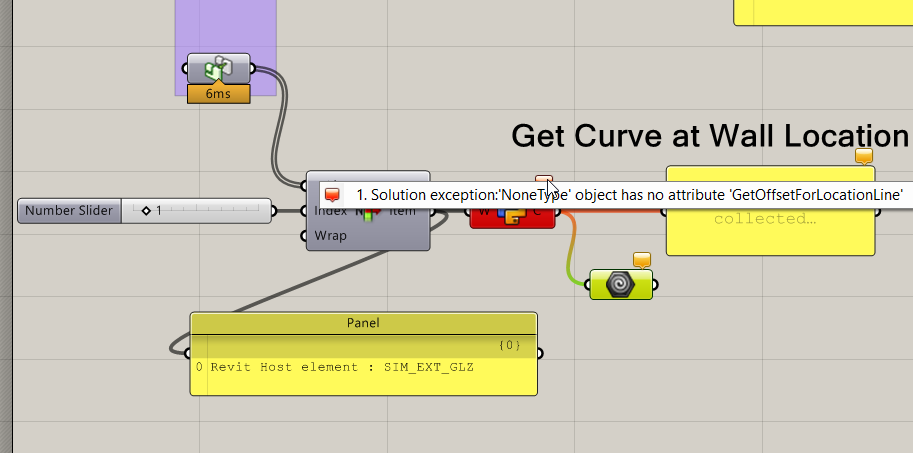

ok, I did detailed tests and can not get it to fully work. However, I prepare a test case for you.

Here is a model with isolated categories:
select one wall and click “IC”

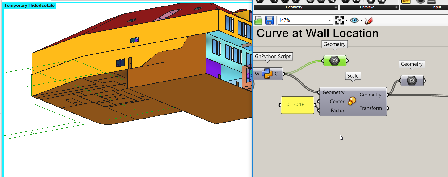

  1. When I take the first wall,
    I can see pulled element but unable to see location line?
    how to make it visible in Rhino?

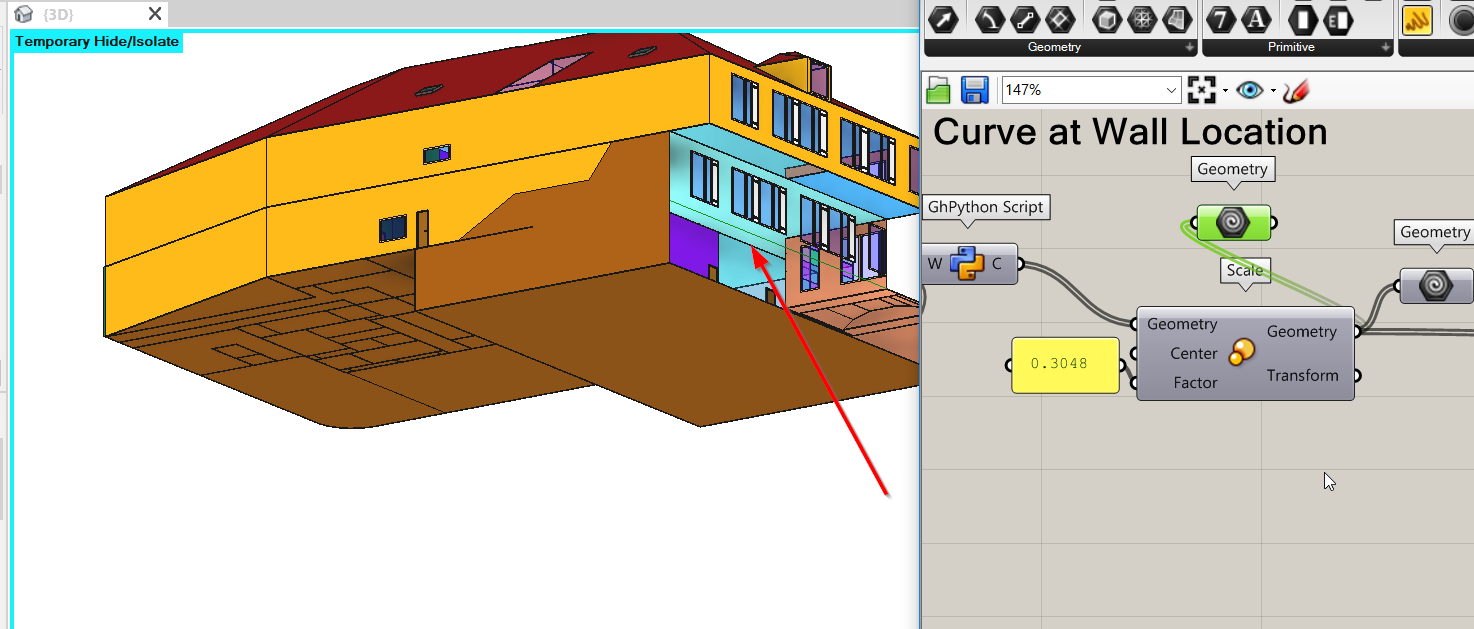

  1. Next wall is not visible

I spent a bit time on this and now understand nr 2,
issue is with units I guess you are pulling internal units feet, so we have to scale it back to meters…and also change Rhino units to meters

Thay’s odd. I just opened your model in Revit. And opened Rhino with Large Objects - Feet.3dm template. Wall curve shows correctly in both apps.
2019-12-16 15_32_56-Rhino WIP
It seems like as long as the correct template is used in Rhino, the definition should work
