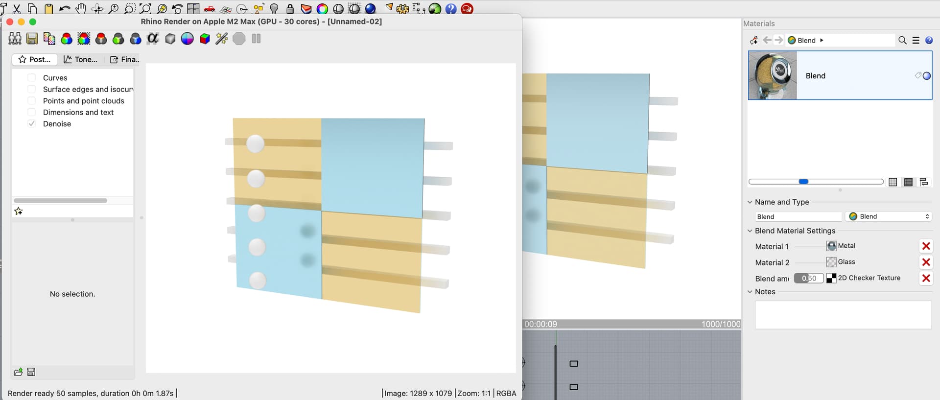

For Raytraced/Rhino Render you could also use a Blend material:
The blend texture is set to mapping channel and a box mapping is applied to the box.

Not sure what you’re talking about. Raytraced and Rhino Render support Blend material just fine, as I showed in my previous post. But just to make sure it is clear, here Blend material again with Raytraced and Rhino Render.
