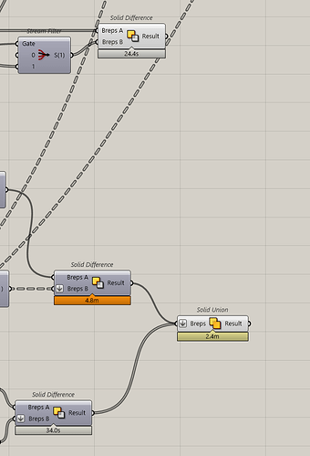

I have three Boolean operators running where the heaviest one runs for 5 minutes. This does a difference on one Closed BREP with 154 other Closed BREPs. I checked all of my data and there don’t seem to be any errors regarding accidentally using a Grafted tree where it needs to be flattened as well.
I’m thinking the main reason why it takes so long is because the outlines I shared in my OP original file are segmented instead of using a curve. I noticed this made it a lot heavier to process. I discovered that other thread about performing booleans through a script and am currently trying to see if that makes a difference. If it doesn’t, I will have to go and see if I can find another reasonable way of offsetting my original curves and lines with something else other than Clipper’s offset method. Beyond that the GH solid boolean operators are just notoriously slow to begin with.

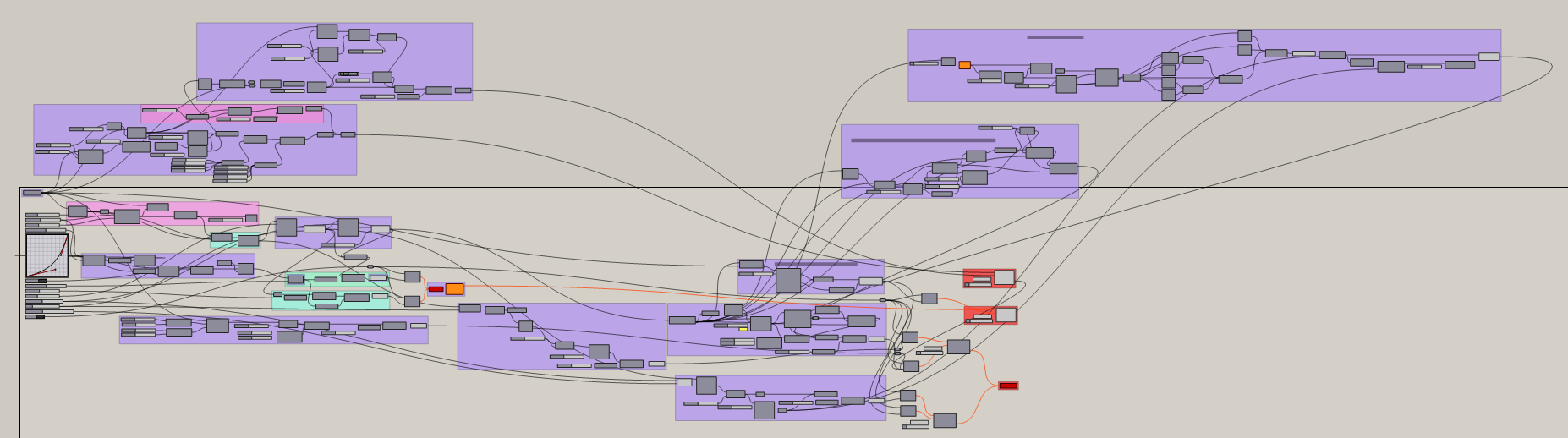

Okay, just a small addition as I couldn’t let this rest :innocent:
I’ve done lots and lots of optimization to the point where I am not sure I can improve it further:
But as you can see, also thanks to this topic: Boolean difference in gh much slower than in Rhino - #18 by gustojunk
Before I found the previous topic, some booleans took over 5 minutes, so in total it was around a ten minute wait. Now it’s around one minute but it feels even shorter. I’ve done a complete rework of every group of components to make it as efficient as possible to my knowledge.
This includes, but isn’t limited to:
  • using the scripted boolean calls
  • simplifying geometry (creating an outline of segments, extruding the outlines, instead of extruding a profile along the segments)
  • changing how some geometry is built by using extrusions and adding a roof instead of extruding a bigger and a smaller shape and then BooleanDifference them
  • many more
I have a few more ideas, such as something I read about performing booleans on surfaces instead of solids.
