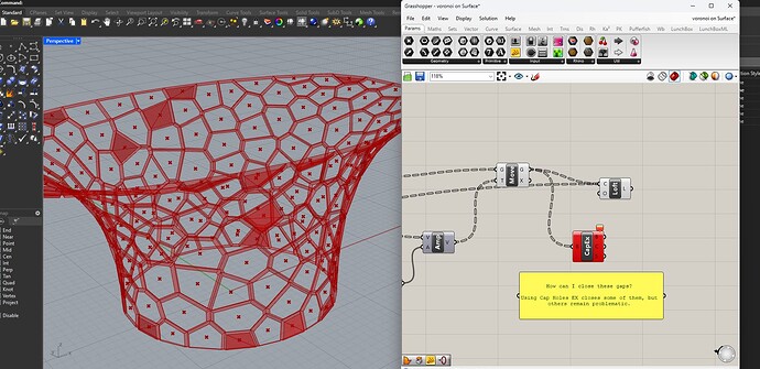

Hi everybody
How can I close these gaps?
Using Cap Holes EX closes some of them, but others remain problematic.

since most of the Polylines are not planar it would be much more difficult to have a smoth caps
btw…
You used patch before (just to get the centers) you could have used it again to close the holes…
(not precize…)
it´s a matter of design…
i like the look created by planarizing the polylines - and in that case patch works precise
voronoi on Surface_planarizedPolylines.gh (20.6 KB)

This works perfectly. I really appreciate your help, Jakob.
