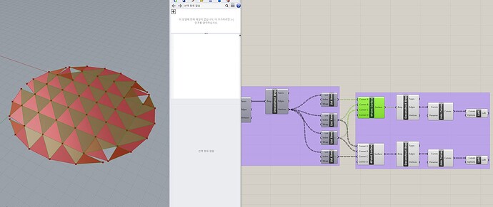

Hello!
Thank you for suggesting a better alternative every time.
I was able to get a result that I liked by referring to your script.
This time, we are going to proceed with panelling to the created structure.
Panelling is in progress using triangular polygons, but there is a problem that the points are strangely connected in the outline.
Finally, I would like to solve this problem because the goal is to proceed with panelling on the three-dimensional curve.
If you don’t mind, can I ask you an additional question about this?

It’s a figure that I’m working on. In that figure as well, there’s a phenomenon where the dots are misplaced on the outer surface.
The figure above is a picture that was modified directly with rhinos. In a rectangle, point is drawn as shown in the figure. However, when the curve is inserted, the triangle overlaps and an empty part is created as shown in the figure below.
I would appreciate it if you could refer to the picture below.

it’s because here you have faces with 5 or more points and you’re extracting four of them, hence the weird outcome
btw, you might want to use quadPanels like so
or even better, a tripanels like so
lastly, trim your mesh with the curve
