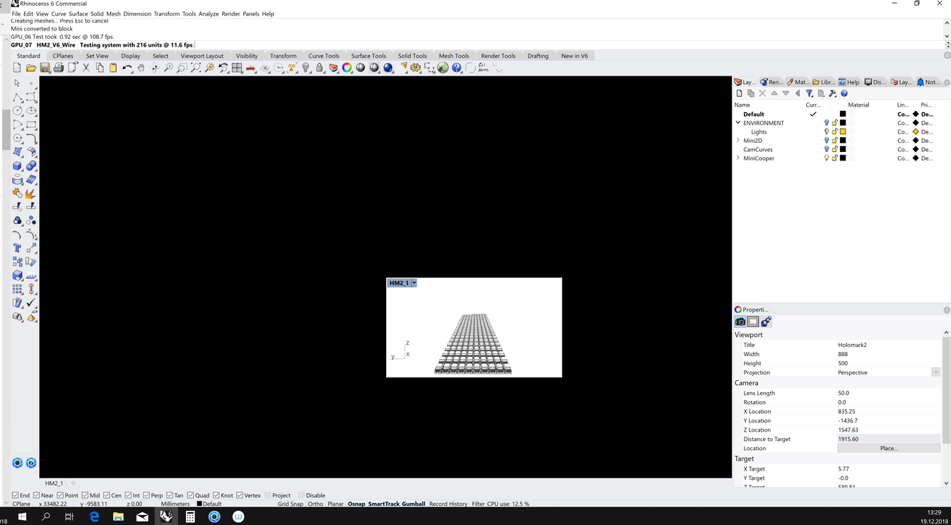

Is it normal that the test runs in a small ?floating? viewport?
I think the viewport size is hardcoded at 888x500
Yes, as @jesterking suggests it’s a predefined size from back in the “fullHD is huge” days :wink:
It is important to test the size in a controlled environment, thus the fixed size and the custom display modes.
The reason for the odd placement is just that Rhino6 closes the viewports in a different order than Rhino5.
I’ll add a note to fix that for the next build.
