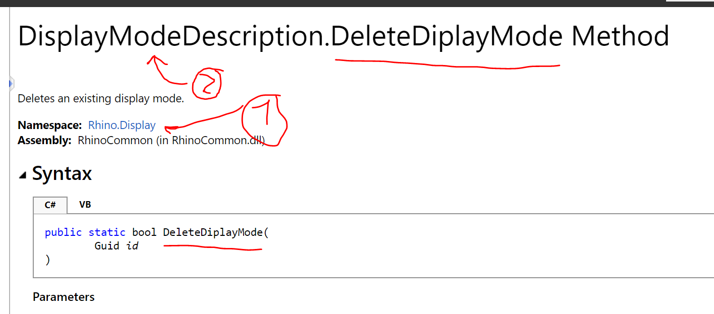

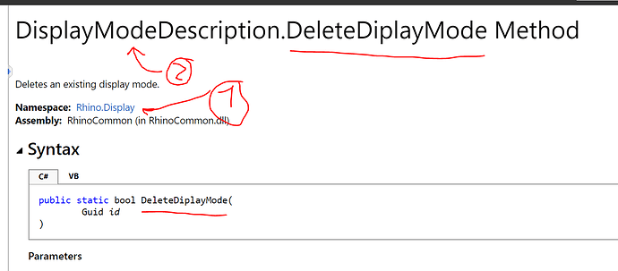

Hi Jorgen -
https://developer.rhino3d.com/api/RhinoCommon/html/M_Rhino_Display_DisplayModeDescription_DeleteDiplayMode.htm
Thanks man, but I don’t understand how to read those pages…
… oh a bit wiser every day…
This one says you can get or set AA:
https://developer.rhino3d.com/api/RhinoCommon/html/P_Rhino_ApplicationSettings_OpenGLSettings_AntialiasLevel.htm
Hi Jorgen - how are you adding the modes?
That’s a trade secret…
(that’s a joke though, but it is so hacky so I can’t recommend it)
But deleting them was quite easy, I’ll add it as an option to Holomark2_R6.
