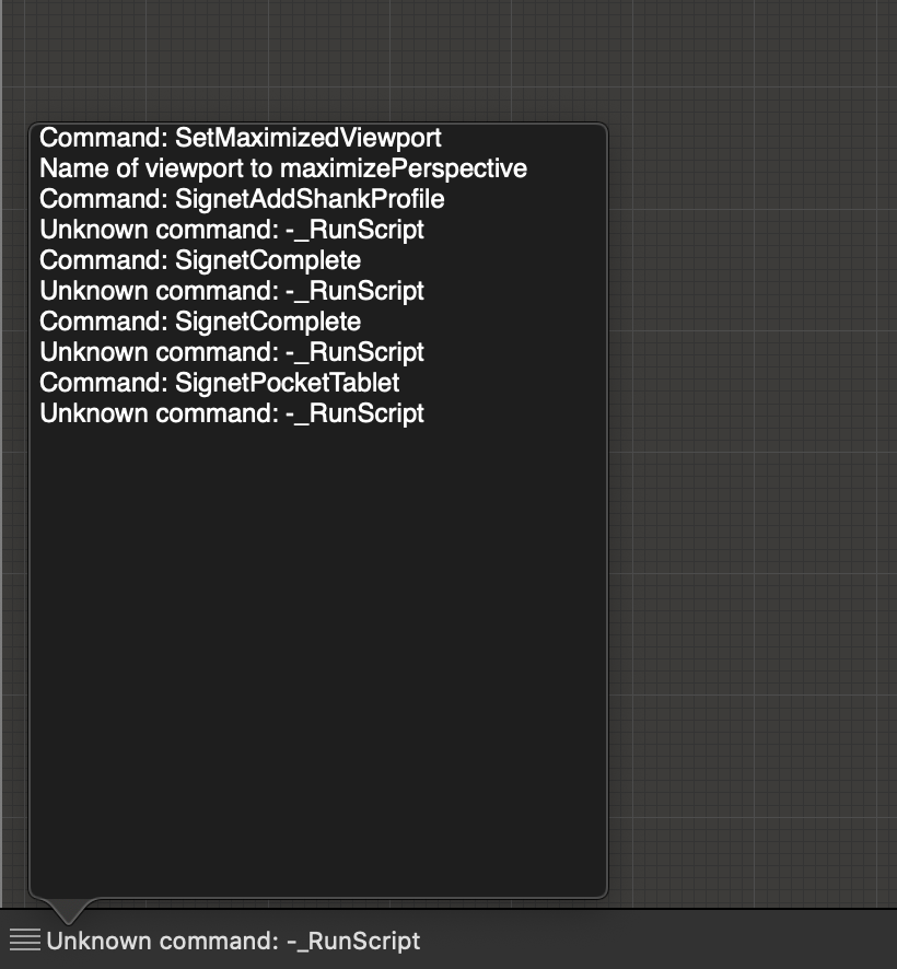

Hi Keith
it tried to instal your Signet Plugin…
Is it only a Windows version? because PackageManager found it and installed on my Mac successfully [which AFAIK has different installer then Windows]
Yet I get this:
Also I couldn’t find any of the tools, only the Aliases in command search…?
thanks a lot
Akash
The plugin is only written for Windows at the moment. Interesting that it even installed on the mac as I have marked it as a windows plugin with YAK (@will)
Yes thanks I had a look in F4R and see it is listed for W only.
Same thing with your Cad Wax !
Package manager certainly need to know this kind of platform compatibility thing. [or at least list compatibility ]
thanks a lot
Akash

Hi Keith -
Are you sure that the previous versions (7.0.0 and 7.0.1) also were marked as Windows-only? If not, you will probably have to yank the older versions.
Hey Keith, Rhino 7 (now in beta!) includes an updated Yak CLI tool that allows you to set the platform that your plug-in supports.
"C:\Program Files\Rhino 7 WIP\System\Yak.exe" build --platform win
If you build the package this way then it won’t show up in Rhino for Mac’s package manager.
